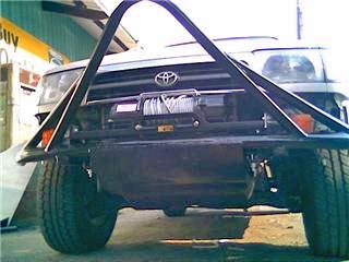

CoalHillsMckracken's Avatar
Joined: Sep 2007
Posts: 50
From: Jim Thorpe PA Mountains
"Hornet" Stinger From "The Metal Works"
Just got this one mounted today. It is a beast and beats a Marlin Crawler any day. It has 6 mounting points, all directly to the frame and is supported well for all angle impacts. It's made of solid Pipe not tube-very heavy. 110lbs
You'll find contact numbers there too for Victor Yordy at the shop .
http://www.themetalworks.net/gallery/
Here's the build pics in this thread
https://www.yotatech.com/forums/f88/...tinger-125060/
Yeah... no
