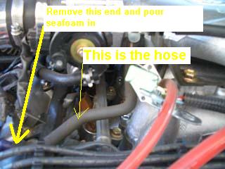

Is this were I can pour the Sea Foam in the intake??

Closer pic.
See the pic...

Thanks Bamachem, I will try it now!

When I pulled out the hose, my motor stalled. I think I have a problem!?

No, it will run like total crap with it pulled. You may need to pinch the hose a little when you do it so not as much air gets in through the hose and leans out the engine...

How about holding to throddle a little bit?
