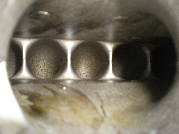

So I was cleaning my throttle body yesterday & when I looked into the plenum I was blown away at how much sh** was stuck on the walls. So I thought this would be an awesome opportunity to see if Seafoam is for real or just another scam. These are pics of the inside of the plenum from where the throttle body sits (duh). I poured 1/3 pint (1/3 of the can) through the PCV vacuum line for more even distribution with engine running, killed engine & let sit for 5 minutes then ran at about 2,000 RPM till the white smoke stopped spewing out. This is a 1999 Limited 4Runner with the 3.4L V6. Judge for yourself if it's worth $10.
BEFORE
Seafoam: Before & After Pictures!!!-12-19-3-x.jpg
AFTER
Seafoam: Before & After Pictures!!!-12-20-2-x.jpg
Better throttle response, seems to idle a little smoother and now I have photographic evidence that it does clean most, not all, of the gunk. Hopefully i'll get a little better gas milage too. I'd say it's worth $10 every oil change. I did notice though that the Seafoam didn't distribute as evenly as I thought it would. The forward most and aft "channels" in the plenum didn't get as clean as the middle "channels" did.

good pics ramrod... nice to se that stuff actually works... kinda sorta...
Makes you think if they had it in a spray bottle with a long wand you could get better control of where it goes...

I have heard that running the stuff through the PVC is better than the brake booster, well now here is the proof.

They do have SeaFoam in an Aerosol can, with a long rubber U jointed plastic hose to allow you to get it into your throttle body while spraying from outside. I tried it and was not impressed. Went back to the liquid in the PCV hose.
