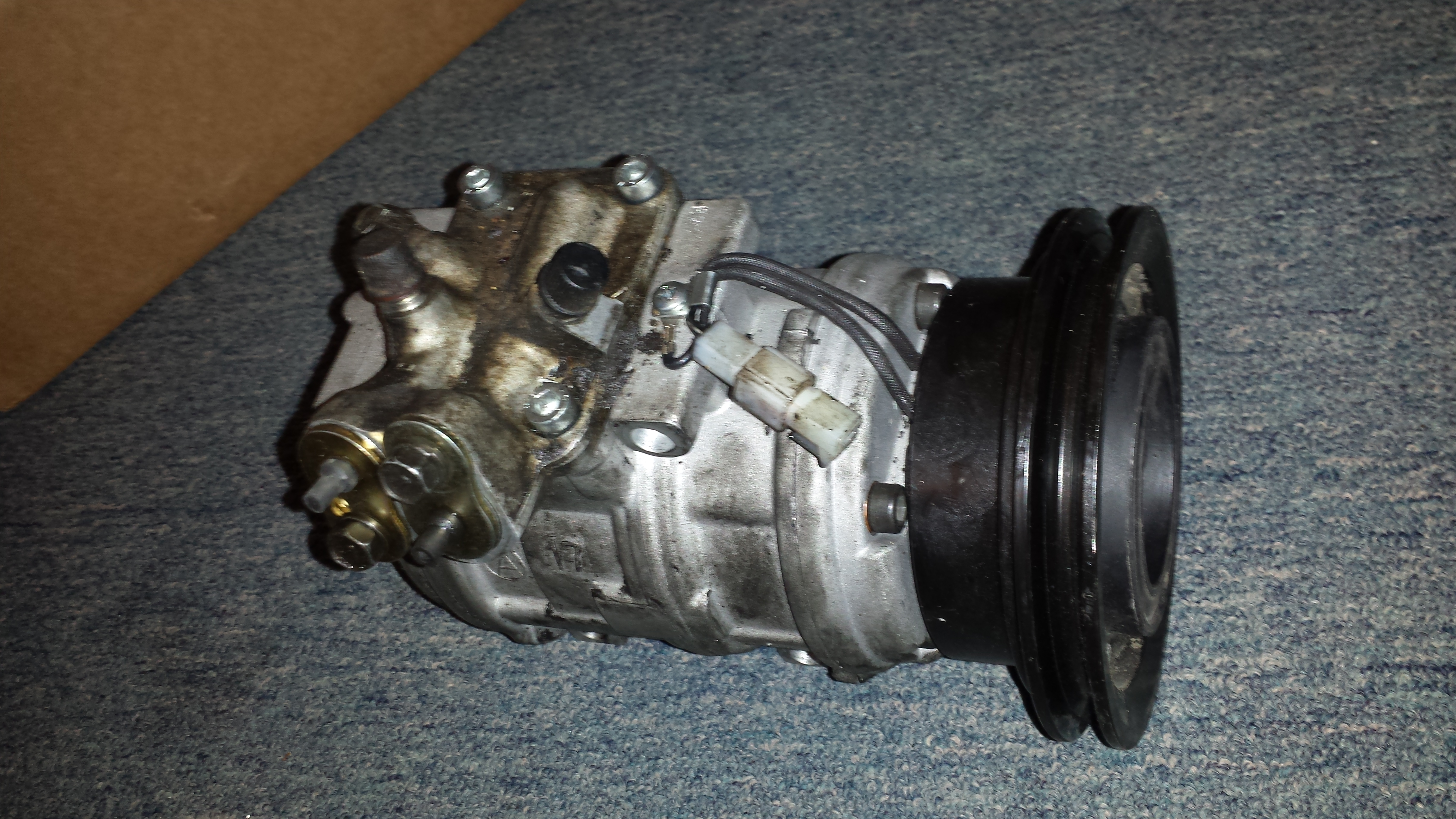

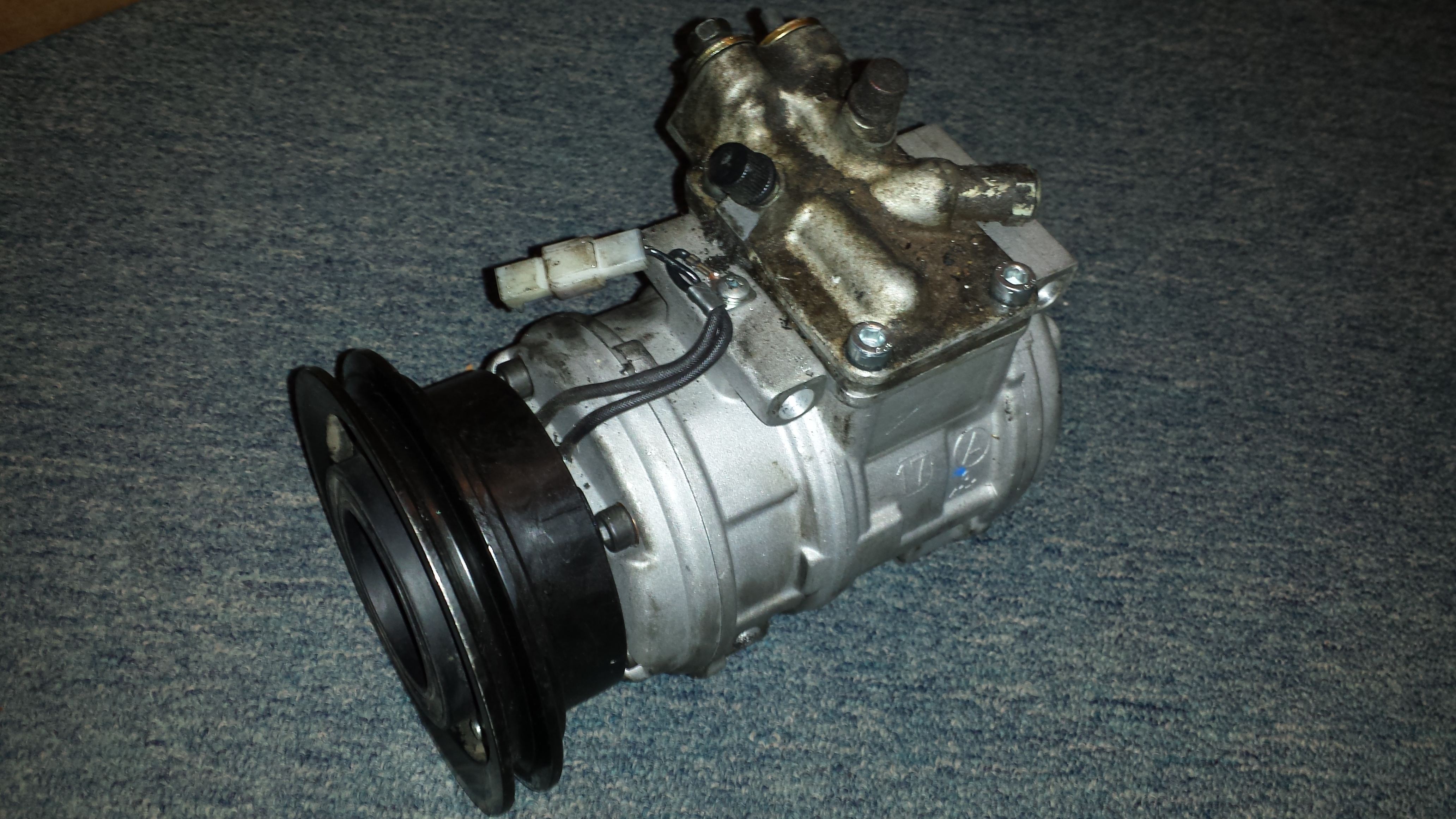

Yup it was the fuse behind right kick panel. Nice and normal 4Runner now ! Thanx all ! New (mounted but never hooked up) R-12 a/c compressor $50

So far as I know, there is "no such thing" as an R12 compressor. They're the same. (I believe Toyota uses the Denso 10PA15C -- at least that's what I used.) What's different is the manifold (the plate on top with the ports), and even that doesn't matter. If you're replacing the compressor, the new compressor doesn't come with the manifold, and you re-use the old one. The R12 ports shown in Bajawfo's picture don't matter; you can either put on conversion fittings, or just leave them alone. You'll be doing your R134a charging through the (converted) ports under the hood up near the evaporator.
What might have happened to Bajawfo is that the "new" manifold didn't have the HOSE fittings for his vehicle (which is why you use the old manifold when replacing the compressor).
Last, since it looks like Bajawfo's compressor was used in an R12 system, it's probably filled with mineral oil instead of PAG 45. But according to Toyota, you don't care. Dump out as much as you can, and fill with the specified amount of PAG 45. The old mineral oil will show up as "bubbles" in the new PAG 45 so you can't use the sight glass anymore, but you don't care (because you're using gauges, not some iffy sight glass).
