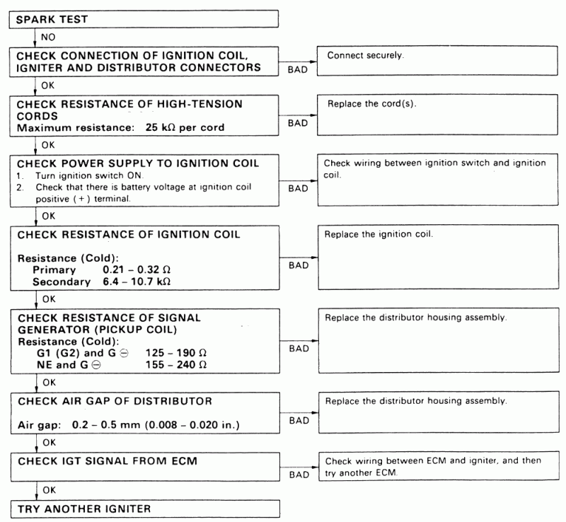

So i have checked the distrib. cap and charged the battery, still no spark at coil.
If i use my multimeter to test coil and igniter, how would i set the OHMs mine goes from 200-200k
I tried the lowest OHMs setting for resistance, at 200 i could not get a reading from the +positive pin to the ignition lead hole
and same setting not all of the pins on the igniter would register a reading..
just anything to make sure it is one of the two or both.
Thanks for all the continued help!

Thank you to every one that offered knowlage, after tinkering with it for 3 days, it ended up being the air flow meter. 1x broken solder. Quick job easy fix. So much drama for one tiny pin...
Again thank you to every one for helping, I am glad i dont have to scrap my camping trip
