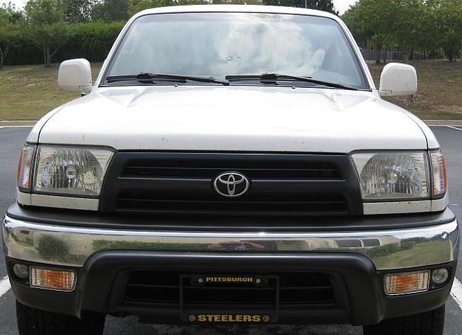

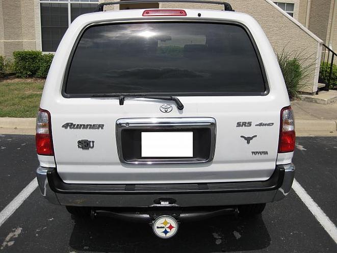

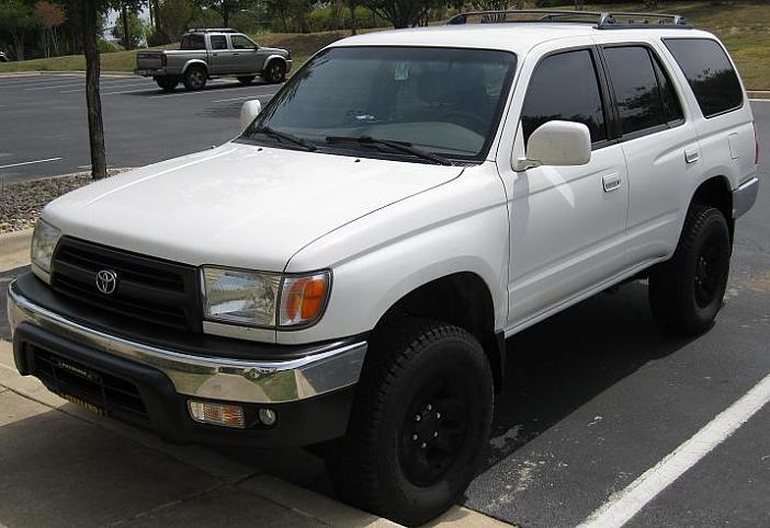

okay guys so I was finally able to tackle this project last weekend. I did most of the prep work that Aviator suggested but I left out a couple of steps and added a couple of my own, I still think it came out great and I am really happy with the results!! While I was at it I also painted all the other gray plastic pieces and my grille black to match. Let me know what you think.

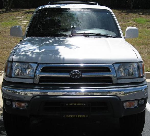

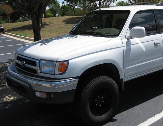

I forgot to post some before pics in my last post so here are a couple before pics.

looks good

Looks sharp.
