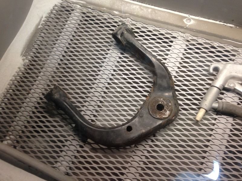

I forgot to update my own thread.
Two months ago I decided to tackle upper control arm bushings, so I purchased a pair of upper ball joints and the four bushings from Toyota. The upper balljoints were a pita to swap (as in the past), but the bushings were quite easy to replace. I took the opportunity to blast the arms, and then etch prime & paint before reinstalling.
For what it's worth, the original bushings look cracked & worn, but were by no means destroyed. Since my steering wheel was cocked after the work, I had the alignment adjusted afterwards.
