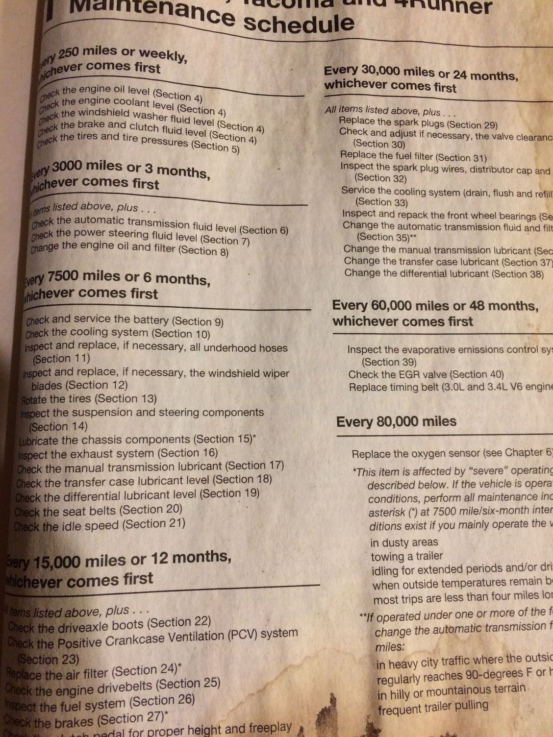

General maintenance schedule question here. Specific maintenence procedures are often instructed to be completed at either a specific mileage or time whichever comes first. For instance in my Haynes Tacoma repair manual it says to replace the spark plugs every 30,000 miles or 24 months whichever comes first. I get that when you don’t use a vehicle regularly it can be just as detrimental or even more so in certain circumstances to particular components than if the vehicle gets regular use, hence the “whichever comes first.” My question is if you use the vehicle regularly, but don’t put many miles on it, should you still base your maintenence schedule off the time if it comes up first? I drive my truck numerous times a week, but I don’t tend to go particularly far (10-20 miles per use usually). The truck isn’t sitting for long periods unused, it’s just not going very far. That will roughly mean that for the 30,000/24 month maintenence I would be hitting the mileage closer to 48 months. I’m not shy about doing maintenence and I certainly don’t want to neglect my truck, but I also don’t want to be tossing money and time at jobs that don’t need to be done. I could also see certain things being more important to do on a time schedule than others, such as fluid changes vs mechanical adjustments. Any suggestions or insight is welcome.
Oh and I don’t figure it matters but I have a 96 Tacoma v6 4x4

Can you post a picture of your maintenance schedule for future reference?

That’s great info, thanks for humoring me with the discussion. It makes sense that Toyota would recommend inspection/services at regular interavals for those reasons. I sort of figured they were shooting for a “you should at least look around in there occasionally instead of driving it into the dirt you idiot” kind of approach. So I plan on being cautious about pushing service intervals too far. As discussed earlier fluid changes and the like make sense to be done at a more timely interval than based on mileage alone. That being said I think for purely mechanical adjustments ill probably stick more towards the mileage recommendation, possibly erring a bit on the early side if it seems like it’s going to be much longer than the time reccomendation. I’m playing around under the hood (looking and listening) frequently enough to hopefully spot anything starting to go bad. In any case thanks again. The tinkering continues!
