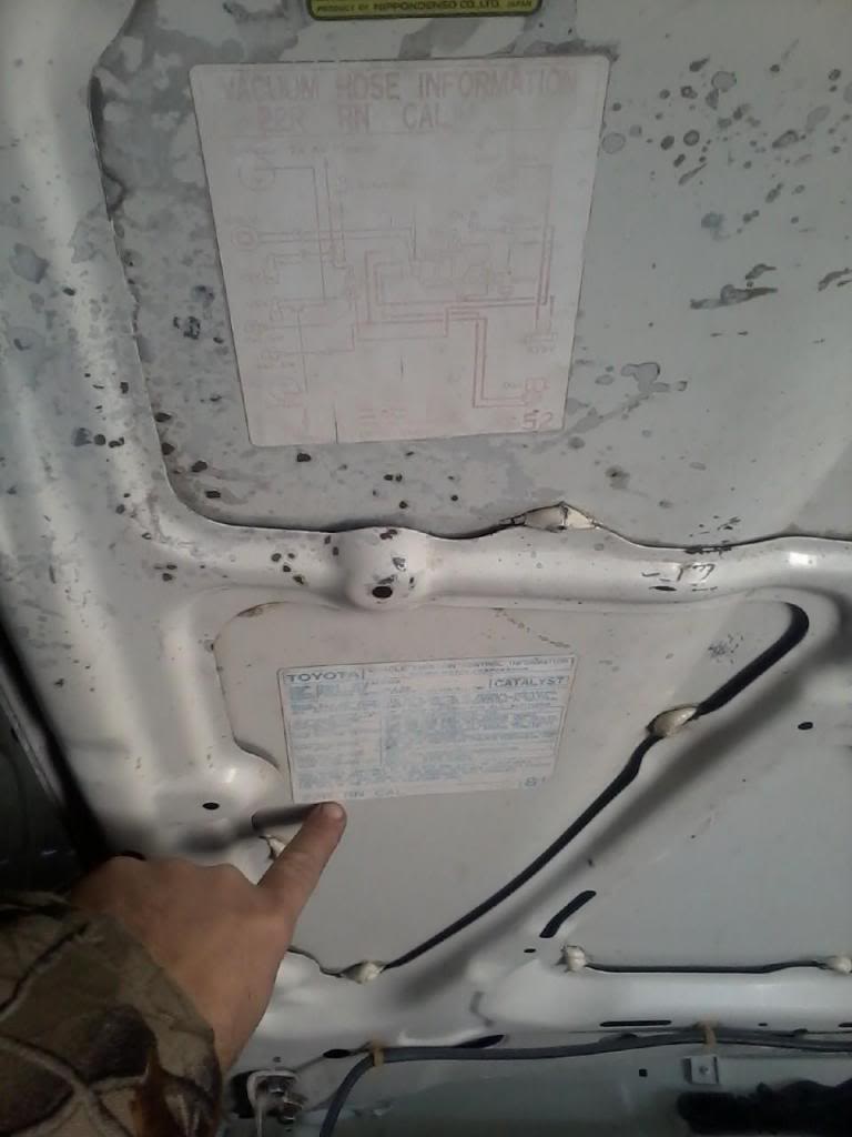

Here is the decal that will say if it is Cal or Fed( this is a 22r but decals are similar). This is a California Emission truck. Two other ways I can help identify a California 22re is that it will have an O2 sensor in front and behind the catalytic converter. Also the EGR will have a sensor with a wire sticking out the top of the EGR. Total 3 ways, Decal, two O2 sensors, and the wire in the EGR.
A lot of the times the stickers will be missing.

That sticker is the Bible for your truck.
I'd remove all the hoses without even looking where they go and replace them with new hose per the sticker.
Thank you, i will look asap.
That is a great idea. With everything that everyone has said so far ive got a good starting point, now i just need some down time to work on it, will update with pics any work i do.
