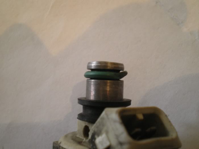

So after having to get my car towed back 300km's last weekend due to a leaking injector, I pulled it apart this morning and think I have found the cause...

Would this cause the injector to leak severely ? ?
All the injectors were ultra sonically cleaned and new o-rings etc put on them less then 3 months ago, so i am assuming that faulty installation is the cause of this as the other 3 are fine ??
Now that I have taken them all out for inspection, do I need to fit new o-rings prior to installing them again or will they be OK ?
Also, can the injector leak internally and find its way out of the section between the actual injector and the electrical connection ? or is that all molded together and no possible to leak ?

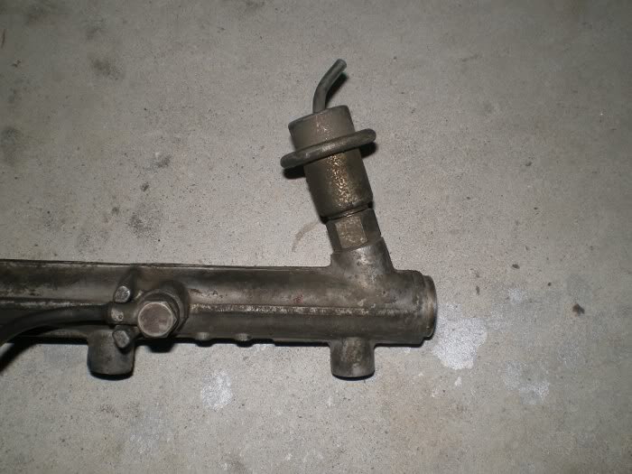

On the fuel rail, there are two items, one is the fuel pressure regulator, and the other I don't know what it is ?
Regulator : ? (on the return end)

For this other one, there is a small Phillips screw in the center of that top hat looking thing that can be screwed in to open the valve and allow less restriction, or screwed out to add restriction. I am guessing this is the regulator ? But everywhere I read seems to indicate that the regulator has a vacuum line attached to it, like the first pic does.
My screw is fully wound in which is allowing NO restriction, so does this mean my fuel pressure will be incorrect , and is this how I adjust it but screwing that screw until I get the correct reading of a fuel pressure gauge ?
Lastly, what are the affects of running fuel pressure too high or too low ?

your preasure regulator is in the back of the rail (w/vacume line). on the front of the rail is your pulsation damper. I know the regulator is not adjustable. I believe the damper also is not. the screw might just be for assembly or inspection something. Yea, Bad fuel preasure: crappy idle , drivability problems, too low at high r's prob loss of power.

Yup, improper installation of the injectors, I did the same thing.
After you get new o-rings, dip your finger in gas and put it on the o-ring, then twist it clockwise and counter clockwise til it is in, and make sure it rotates freely.
After you put them in, make sure everything is tight, and test it, short two terminals on the diag. port, B+ and FP I believe and let it run for about 30 seconds or so, checking for leaks. Good luck!

i had this same problem, i forgot to put my injector seals in and it leaked gas.
new rubber seals and it was all good.

witchhunter's website says to use a little bit of oil on the O ring when you reinstall, i had to redo my number 3 injector FOUR times. talk about PISSED. i finally looked up stuff and read that on their site and when i put it back in i just opened my oil cap got a little on my finger and rubbed it around the O ring, twisted it in and it felt like a hot knife in buter just popped righ in and no problems whatsoever after a week and a half
