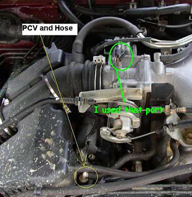

Can someone point out the PCV hose or Brake Booster Line for me on a 3.0L 95 4Runner?
Is Seafoam poured in or sucked in?

here's a pic that i found. I used the PCV hose.
https://www.yotatech.com/attachments...-4-intake2.jpg
i poured it in very very slowly so that i don't hydrolock my engine. I read one report of that and was afraid.
So in the end i did 1/3 into the PCV hose, then 1/3 into the crank case on an empty tank of gas.... ran the engine and it smoked for a good amount of time. My engine is more responsive now. =)
Then i filled up my gas and put in a pint of seafoam and ran the last 1/3 of the first can into the PCV hose again. I smoked out the gas station i was at and a cop drove up to me. I thought he was going to tell me to turn off my engine, but he just got on his cell and made a call. after the 2nd time my car was running pretty smooth. I like! thanks for the help! i'd suggest this stuff for a quick clean.

Don't use the brake booster line of the 3.4. It only feed 3 cyliders if i remember right. Use the PCV as it feeds all cylinders.
