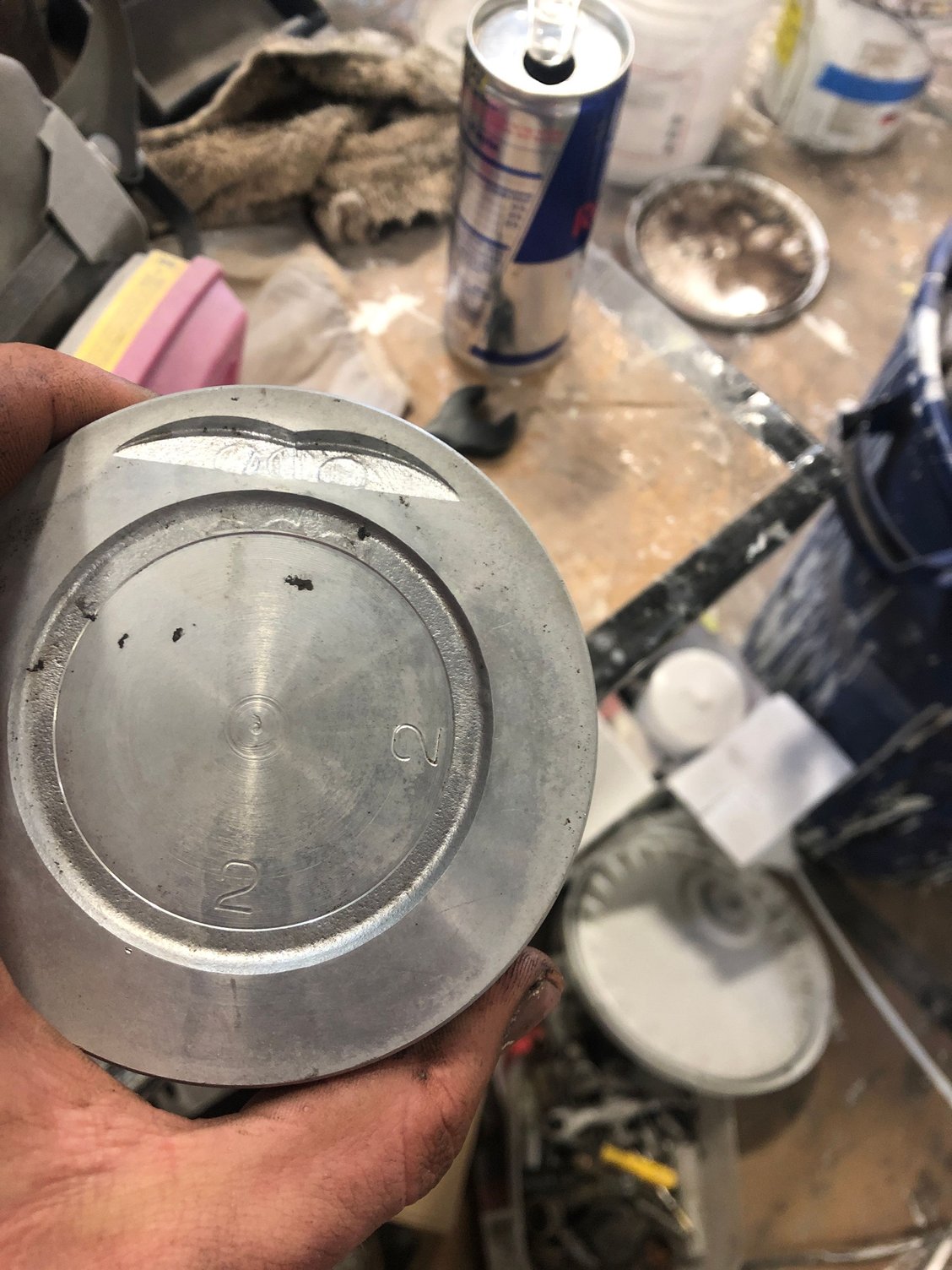

What are these numbers on top of my 22re pistons?

Hmm, that looks like a "2" to me..
I'm sorry dude, I couldn't resist! I'll see myself out...
Also interested in what those numbers mean though, good question.

Likely just some mold ID markings. Are the whole set marked the same??? Are they supposed to be oversize???

Their cylinder numbers. Each component (piston, rod, rod caps) are numbered 1-4 to indicate the cylinder.

Originally Posted by eric-the-red
Just to confuse you some more the FSM shows 3 different piston sizes, marked 1, 2 and 3. The diameters are
Size 1.... 3.6211-3.6214" (91.975-91.985 mm)
Size 2.... 3.6214-3.6218" (91.985-91.995 mm)
Size 3.... 3.6218-3.6222" (91.995-92.005 mm)
The bores should also be marked 1, 2 or 3, to match the pistons.
