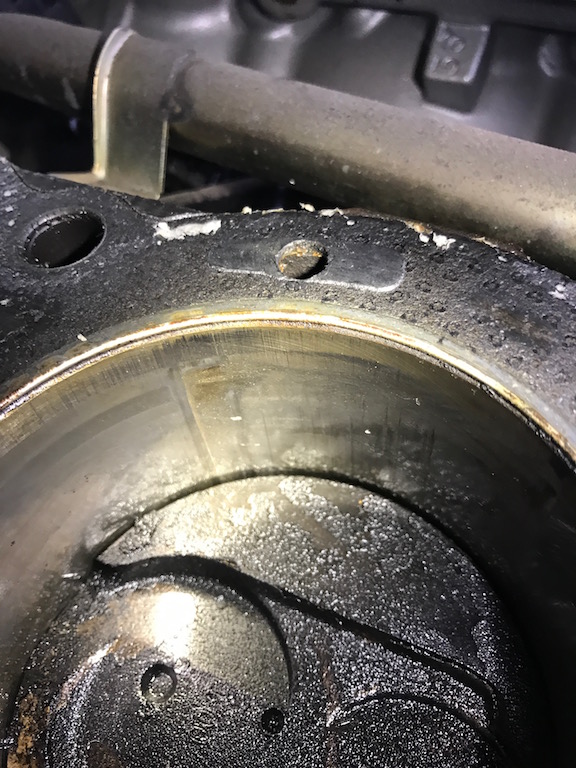

I have a 3vze out of a 94 4runner. The engine failed and the #4 piston is trashed. The engine has been rebuilt before it seems. The rod bearing is .025 and the piston has a 1.00 stamped on the face.
I have searched and can't seem to find out what the 1.00 signifies. Anyone know what that means?

If your number 4 piston failed just how bad is the cylinder of number 4

The Cylinder walls are scratched pretty badly. I am going to call the machine shop this morning and see what they think.
I'm trying to figure out why the rings failed. The story was the car may have sat for a while after it was rebuilt. No way to know for sure.
I attached a couple of pictures. One of the cylinder wall and the other of the piston.

Just talked to the machine shop. He confirmed that info and said the block is toast. Not even good for a core at this point.
Moving on to plan B
