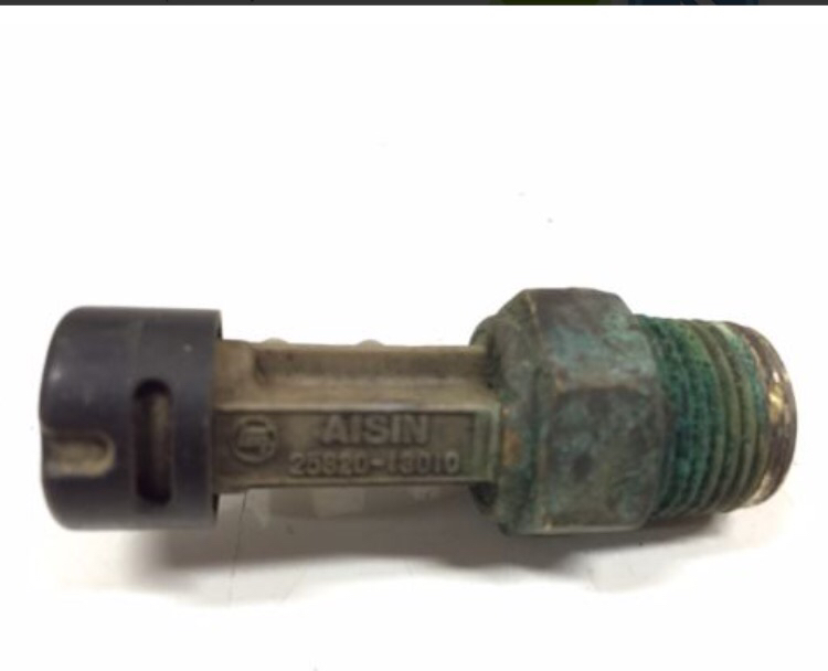

Can anybody tell me what this is and what this does. Vacuum switch sensor?? I broke off the tip when trying to replace a leaky hose. I don't know if it needs replaced or if I can just glue it back on.but I'd really just like to know what it's called and what it does. 1995 Toyota pickup dlx 3.0 v6 4x4 What is this part?-image-1086934259.jpg

Forget the name off the top of my head, but your right about a temp switch for vacuum lines. Part of EGR system. If your in an emission state you gonna want to replace it.

So what exactly does that do? I'm not in an emission state, but will my truck run fine without it? I know I need the bolt part screwed in so coolant doesn't come out. But i don't know what the 2 hoses that plug on it do.

No. It's the TVSV/BVSV/TVV. Which is for the EVAP system actually. It's a good thing. You want it working(emissions or not). And didn't I answer this already today?

You can bypass it.
It opens when the coolant temp reaches 95 deg F which is quick.
The hose runs from the evap canister to the switch then to a hardline and then a hose to the intake manifold.
