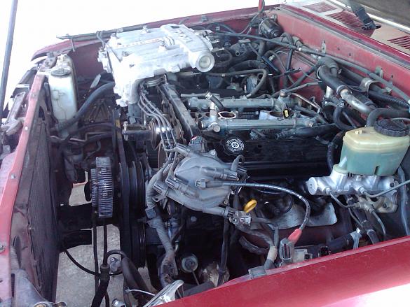

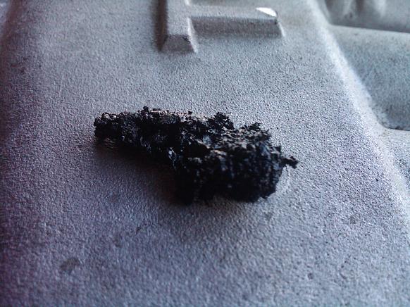

ok during the weekend I decided to take the engine off and have the heads checked by my local machine shop...but look what I found.
Attached Thumbnails used or rebuilt?-img00138-20100224-1351-1-.jpg   used or rebuilt?-img00139-20100224-1351-1-.jpg   used or rebuilt?-img00137-20100224-1350-1-.jpg

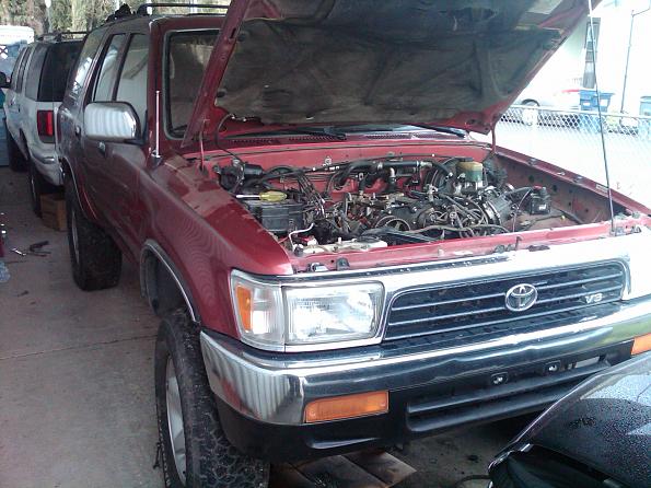

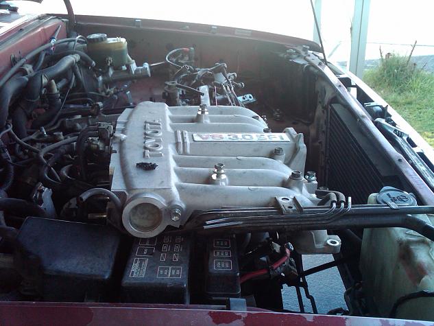

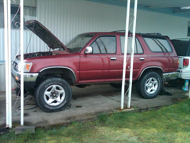

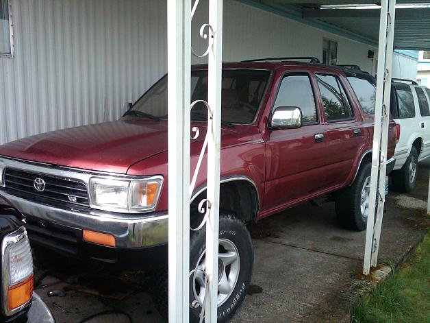

and here some pics of the 4runner
Attached Thumbnails used or rebuilt?-img00150-20100301-0922-1-.jpg   used or rebuilt?-img00152-20100301-0923-1-.jpg   used or rebuilt?-img00153-20100301-0923-1-.jpg
