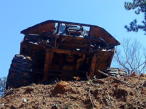

well got the new tires 35x14.5 15 rims
they rub just a little at full steer.
Attached Thumbnails tire fitment?-dsc00050.jpg   tire fitment?-dsc00049.jpg   tire fitment?-dsc00048.jpg
