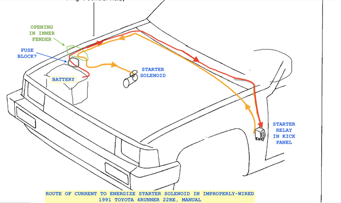

Originally Posted by old87yota
I think the starter relay on your 1989 Truck lives on the passenger side fender apron and is a stand-alone unit, at least according to this post: https://www.yotatech.com/forums/f131.../#post51275843
Yeah, I think it looks like this. green relay.
According to JPL's checks (photo with notes below) the starter relay on this gen is wired correctly. However, the cranking current still has to go over an unnecessarily-long path.
STARTER PROPERLY-WIRED PER MEMBER JPL'S CHECKS BUT CRANKING CURRENT STILL HAS TO GO A LONG WAY
MEMBER JPL DID THESE CHECKS AND VERIFIED THAT STARTER RELAY IS WIRED PROPERLY

WMG092959,
Why do you ask?
Humm... your picture isn't showing up on my end....
Edited above...
I think something changed with Google Photos settings.

WMG092959,
Why do you ask?
This MAY BE my problem.
If relay test's OK. Then I guess it's starter replacement time....... YAY
Don't jump to conclusion. It took us a long time to learn our trucks.
I'm willing to bet your starter and your starter_relay are FINE.
Put us at your truck.
Model - year - engine - transmission?
What do you see?
Pics of relay AND SURROUNDINGS?
Wire colors? Pin-outs?
