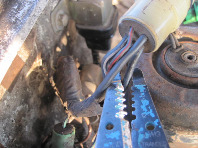

(1) So is this the wire to cut( the one the pliers are on)?

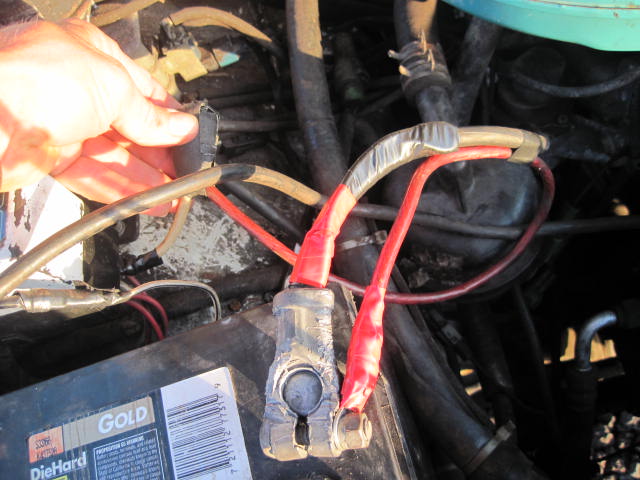

(2)this is my replacement for the fusible link, 6awg speaker wire, from batt to 80 amp fuse

with pic #2 that is the sautered splice I am holding, the 80 amp is in the fuse box , fyi
(3)this will go inline on the bypassed wire w/ a 30 amp fuse
DON'T Cut it too close to the connector, so you'll have room for changes, if necessary. Peel a few inches of tape off the wireloom and make the splice there.
Correct, but don't cut too close.
6AWG is way more than big enough. 12AWG will handle the 15AMP to energize starter solenoid.
Not to 80AMP fuse. Simply move Pin 4 of relay upstream of ST1 contact of ignition switch. That's between IGN and 40AMP fuse. This bypasses ST1 contact of ignition switch, the way Toyota SHOULD HAVE done it.
OR Batt positive - to inline fuse - to Pin4
Hard to see how you're wiring it unless you show pictures of where everything goes.

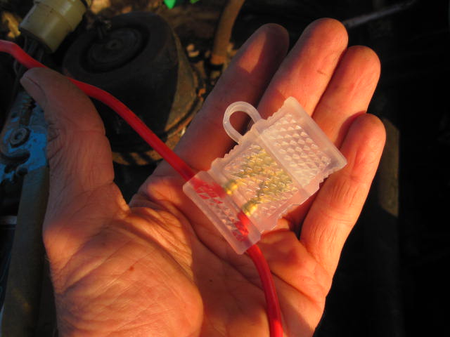

Here we go, thats 12 gauge to a 30 amp fuse to the pos post, with a hillbilly crimp job, I will sauter it later.
I finally did the repair,
Yeey! Glad to know it worked for you. Way to start the new year
I still dont understand what I did, the truck seems to start better and it feels good knowing I am not frying my ignition switch, thanks for all your help guys.
You just did the right thing
Here we go, thats 12 gauge to a 30 amp fuse to the pos post, with a hillbilly crimp job..
