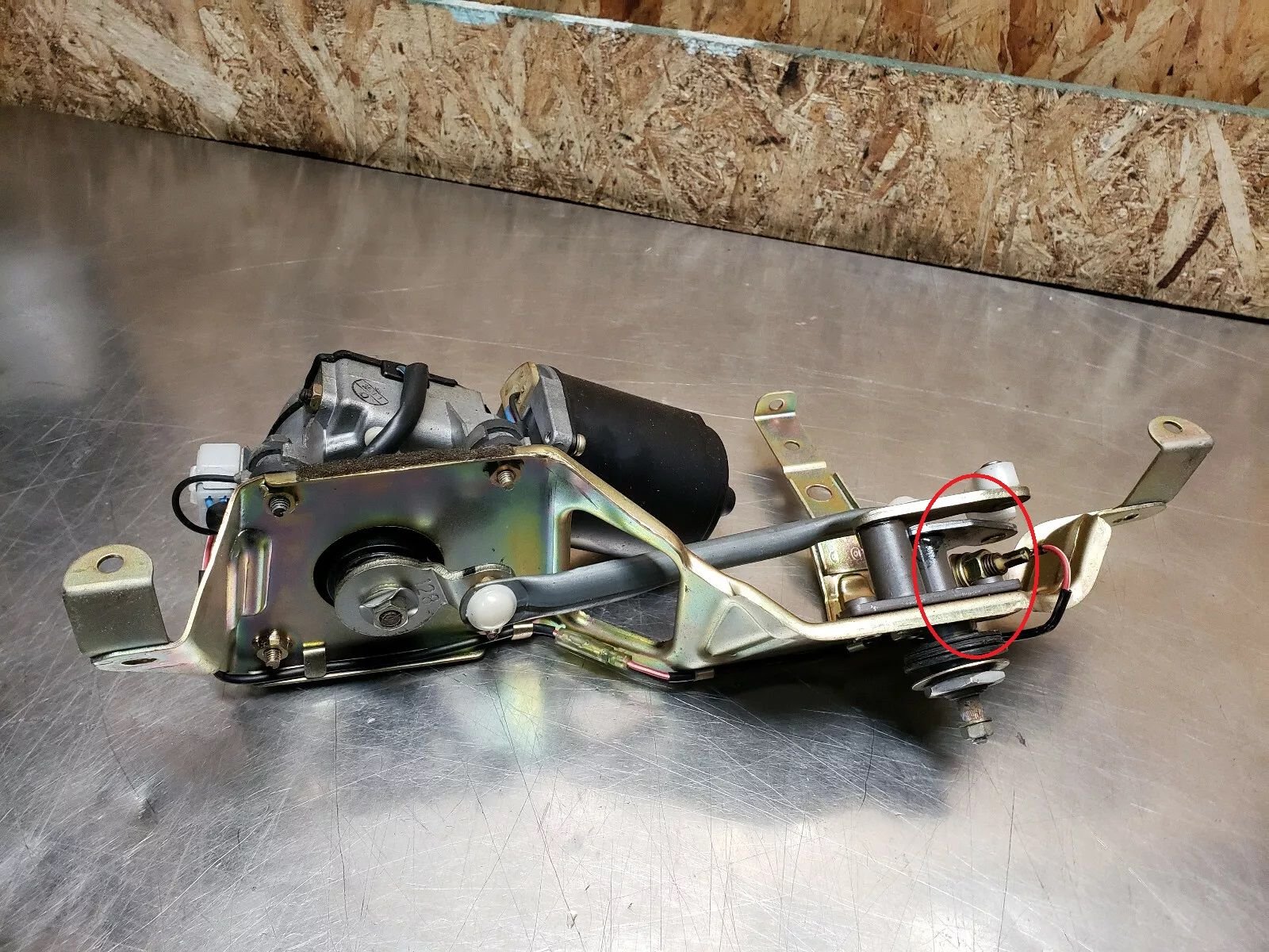

If you have an aftermarket wiper blade on your vehicle getting the small toyota one might help. but here's an image i found, showing some sort of sensor at the wiper pivot. No idea what it does, and it's not listed seperately .

Yes I see that sensor, it is the 'parked' position sensor, officially named as "REAR WIPER RETRACTION DETECTIONS/W" on the wiring diagram. I found that if you unplugg the single wire that leads from that sensor into the 6 termnal plug that you have to disconnect when removing the wiper motor assembly then the wiper and washer system still works and the window will work also but of course the wiper never 'seats' into the 'park' position when finished. That's why I unlugged it (it actually has it's own bullect connector between the 6 pin block and the sensor, you can see it in your photo, almost cetre of your pic, red/white wire in bullet connector).
I can only assume at this point that the Power window relay' serving the rear window has an inbuilt function to 'park' the arm/blade when finished wiping.
Can anyone shed light on that function? Maybe I'm over thinking it?

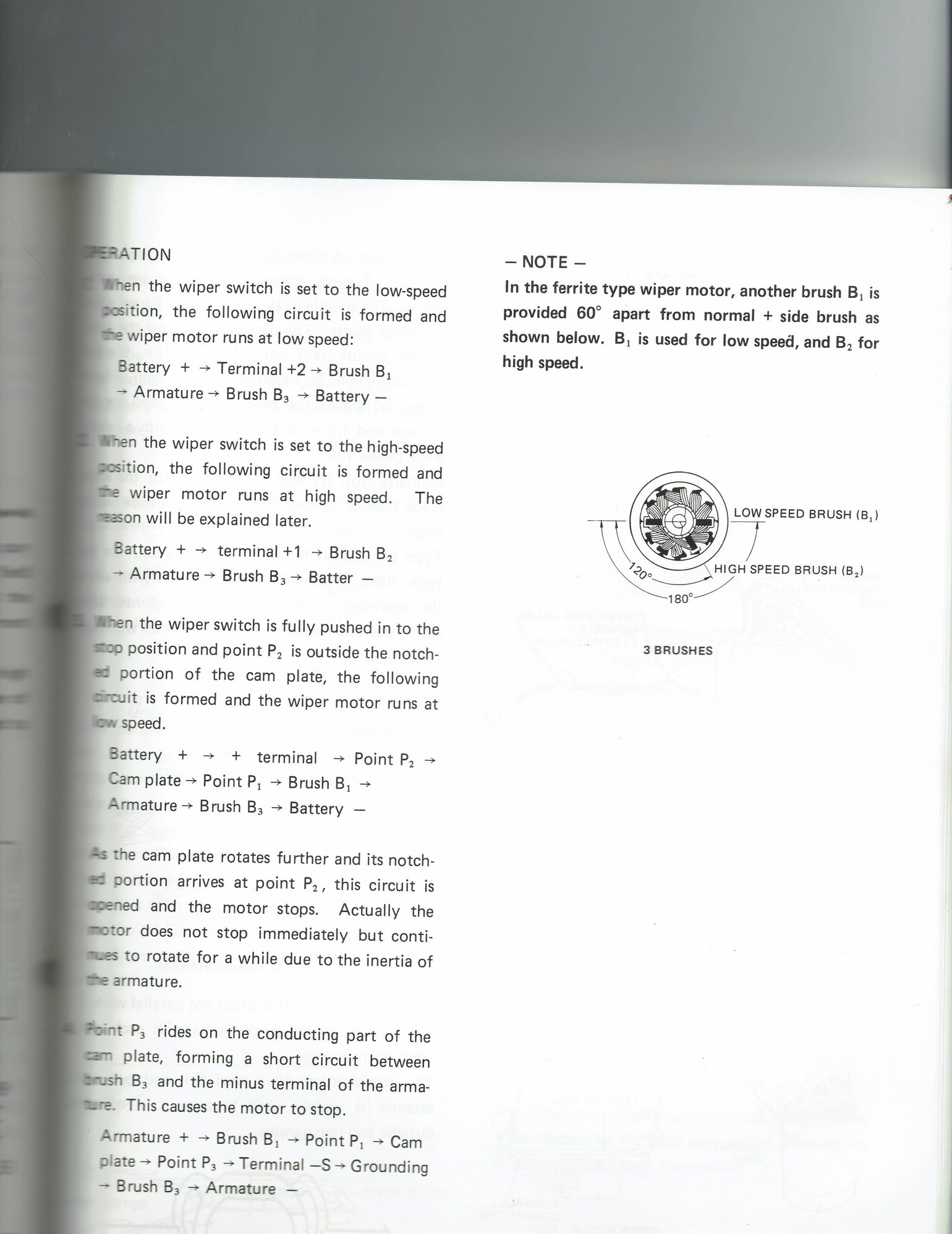

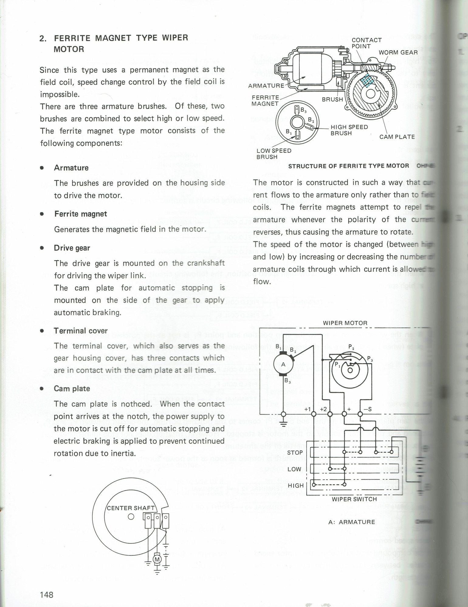

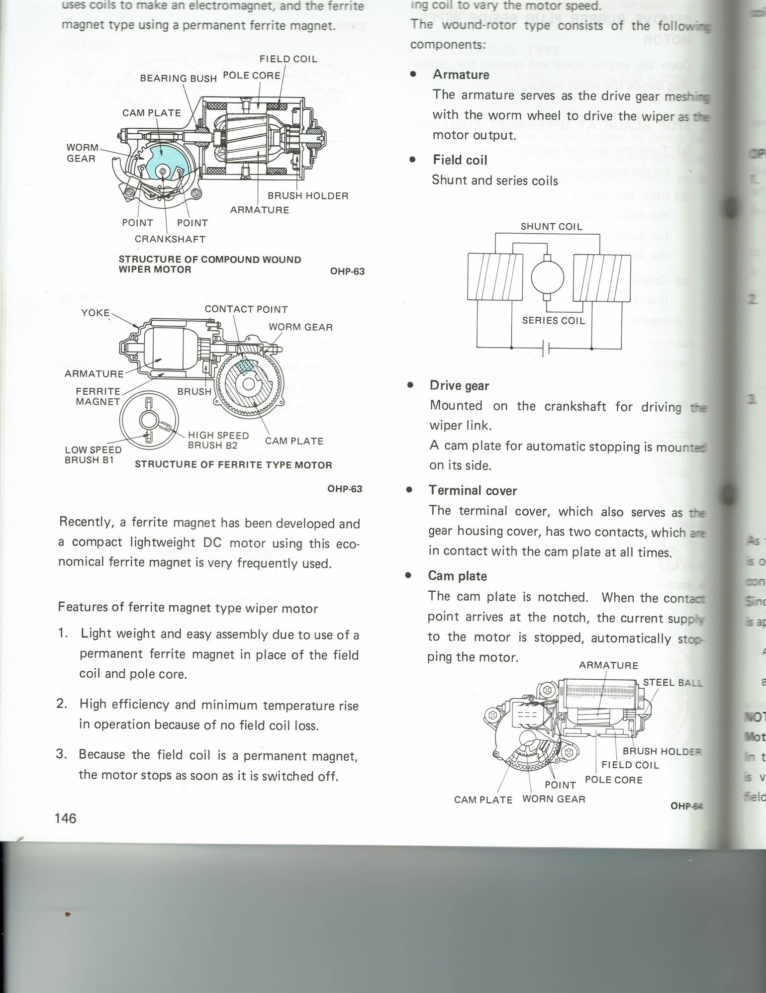

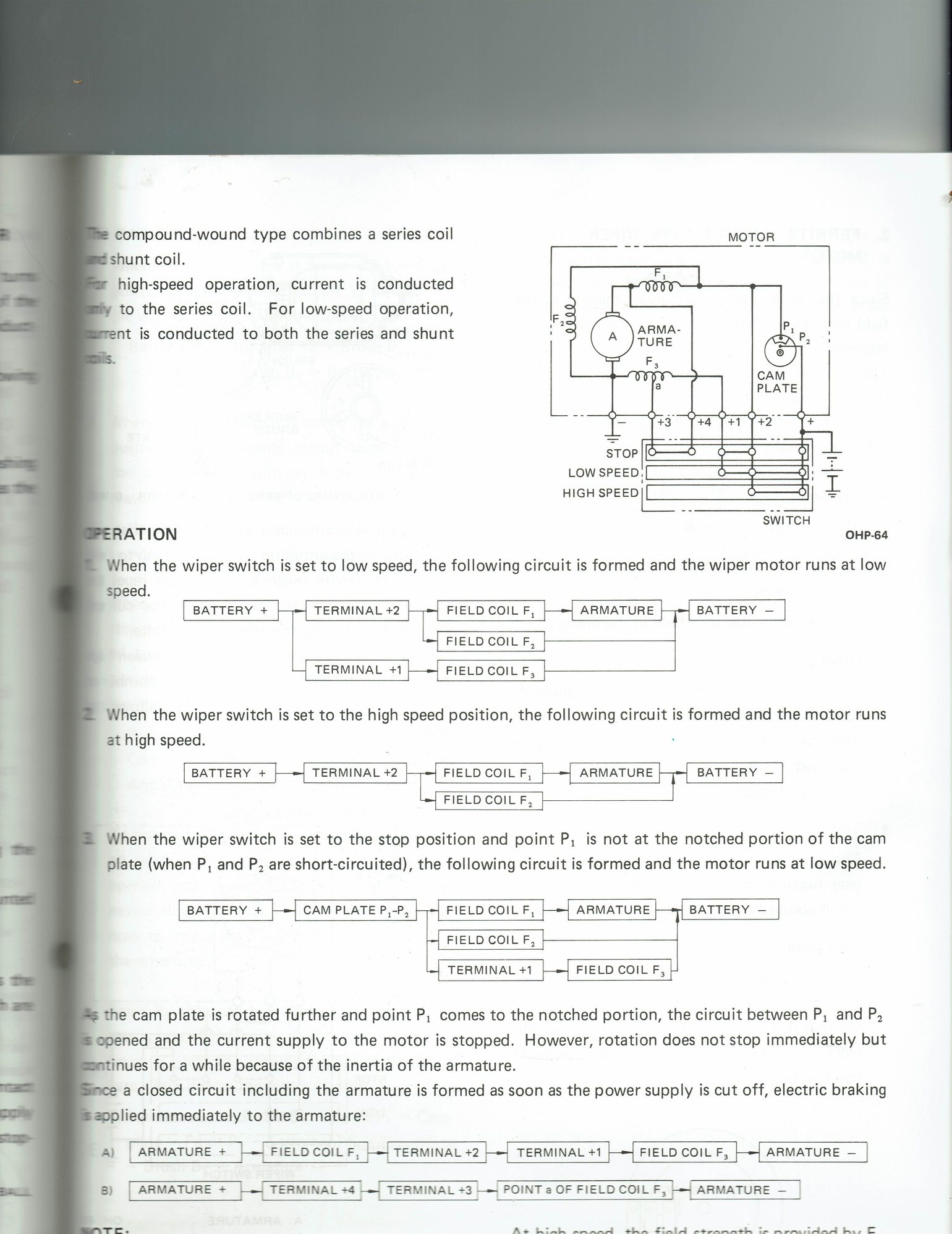

This manual was from a Toyota body electrical class for techs. This was published in 1988, so relevent. I tried scanning the pages, but the binding wasn't making it easy. I'll try and get betterimages. but it seems the parking is done via notched cams in the motor housing.

Hey Jim thanks for your help, I have a tough time reading that but yes I see it mentions a notched cam, it also talks about two speeds for the wiper, is it referring to front wipers here? I don't recall having more than one speed on my rear wiper. Good manual, I'd love to get a hold of one of those.

You have to remember, this manual was for tech classroom training purposes by the factory, so the info in the book covered the way components worked and systems were designed in all models. So if the pictures don't look exactly like what you have don't be surprised. But the way it worked should be very similar. This book doesn't have diagnostic procedures, either. Just an overview.
it does show front and rear wipers in a schematic, but delves more on the front since it’s got more features.
i dunno where you could find this, it was a training book. But techs were allowed to keep their copy once the class finished. So maybe eBay?
I'll get better images tomorrow.

Ok. I deleted my first images and replaced them with new ones. Take a look.
Sorry they're so big. I'm still waking up. More coffee.
