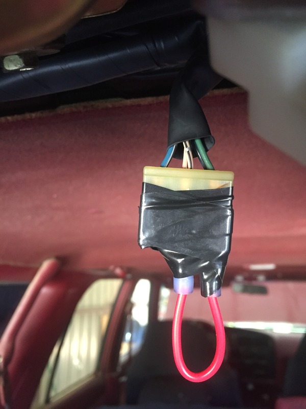

Is there a thread on how to bypass the rear wiper limit switch. This one didnt dock and the guy ripped it off and doesnt want it back on so i need to bypass the limit.

Or where is the switch and ill tear into it and jump around it for the window to always work

It is all part of the wiper motor assembly when it is docked it allows two wires to go back into the wiper /window relay .
this is going to take some looking at schematics and meter work
I have the 92 EWD 93 might use different color wires

Im going to try pulling the fuse with the wiper thinking its fully retracted since there no wiper anymore. If the window will still move up and down without power telling the relay block the wiper is docked ill just tie wire it where it cant move. But if that doesnt work its looking like the only other option is to completely rewire from the switch to the window motor.

Heres the final outcome.
With the wiper unpluged i put a jumper between terminals 4 and 5. Now even with the wiper unplugged the window will still work.
