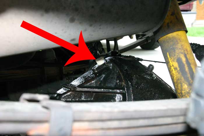

We have a 1979 Toyota that had a leaking differential, so today we pulled the rear-end, replaced the gasket (stopped the leak!) and found a quarter-sized hole on the top of the differential with a smaller hole, threaded, that looks like it held something in the hole...our book shows nothing of the kind and I wonder if anyone knows what that hole is for......and would pass the info on to us!

I didn't get a picture, but it is not the breather...the breather is on the axle housing, this hole is on top of the 3rd member, right in the middle...
I'll see if I can get a pic...

Here is a pic...the arrow is pointing at the cork that I stuck in the hole...the hole is around the cork...

huh idk ive never seen a hole right there

ABS Sensor, put a freeze plug in and call it a day, or go to pull a part and get a sensor and cut the wires.

I don`t think that is the original third member in that truck, that hole looks like its for an ABS sensor.

I think he already plugged it in the pic

Thanks for the replies! I thought perhaps it was for an ABS for whatever vehicle it came out of...suspicions confirmed!
