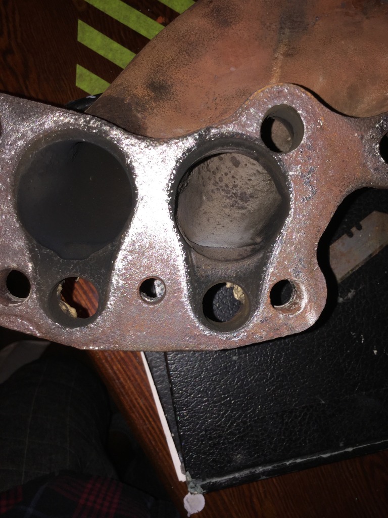

update #3
I took off the exhaust manifold and I didn't see any obvious leaks.
I heard (but didn't feel) what sounded like an exhaust leak coming out of
cylinder 2 before I took it off. I suspect something's up though cause check out the manifold coming out of that cylinder..what could be causing that?
#3 and #4 look like #1
I checked the spark plug and it seemed ok. also, I checked the warpage of the manifold and it's probably around .7mm (my biggest feeler gauge was .633)
there is some indication that there might be a leak at #2 (around 11 o'clock) so I will go ahead and resurface the manifold for $60

new gasket. Once I do that I will try and adjust the valves and since nobody is reading this,

Are you sure you're not hearing pinging? If the noise is still there after you get the exhaust manifold decked and installed, I'd try higher octane gas. If that eliminates or reduces the sound then you know for sure it's pinging. At that point I'd start chasing down vac leaks, ohming out all efi and ignition sensors hot and cold, (start with cleaning the throttle body and a TPS check/adjustment) check for faulty/sticking/clogged injectors, faulty fuel pump or fuel pump wiring.

When I took the manifold to my gearhead friend and asked him about the suspect port for cylinder 2, he found a crack so I went to the junkyard instead and got a old new manifold.
What a difference! The sound is gone, I feel a slight increase in overall power (I never used to go to 5th gear up this hill to town) but now there is a hesitation (truck jerks sometimes
when accelerating. I hope that new plugs will solve this as I did notice that plug 2 was caked with white build up that I think is a result of the leak and the advanced timing (that I corrected)
making the mix super rich. I wonder how long the ECU takes to readjust the mix after I made all these changes..

there was a small crack in the exhaust manifold that I discovered because I took it off. I was going to get it machined flat as there was a slight warpage. it was at spec limit but I figured I'd try anyways cause it was driving me nuts. I was doing the plastic tube trick to the ear to listen for any weird sounds and only could hear a very slight little rattle when I put it near the #2 exhaust. the problem was that I could only hear the slight rattling sound during idle and it wasn't when the truck was going that it really made the noise. my friend saw the tiny crack then it was off to the junkyard to get another manifold. bonus because it had an intact heat shield.
hope that helps and good luck!
