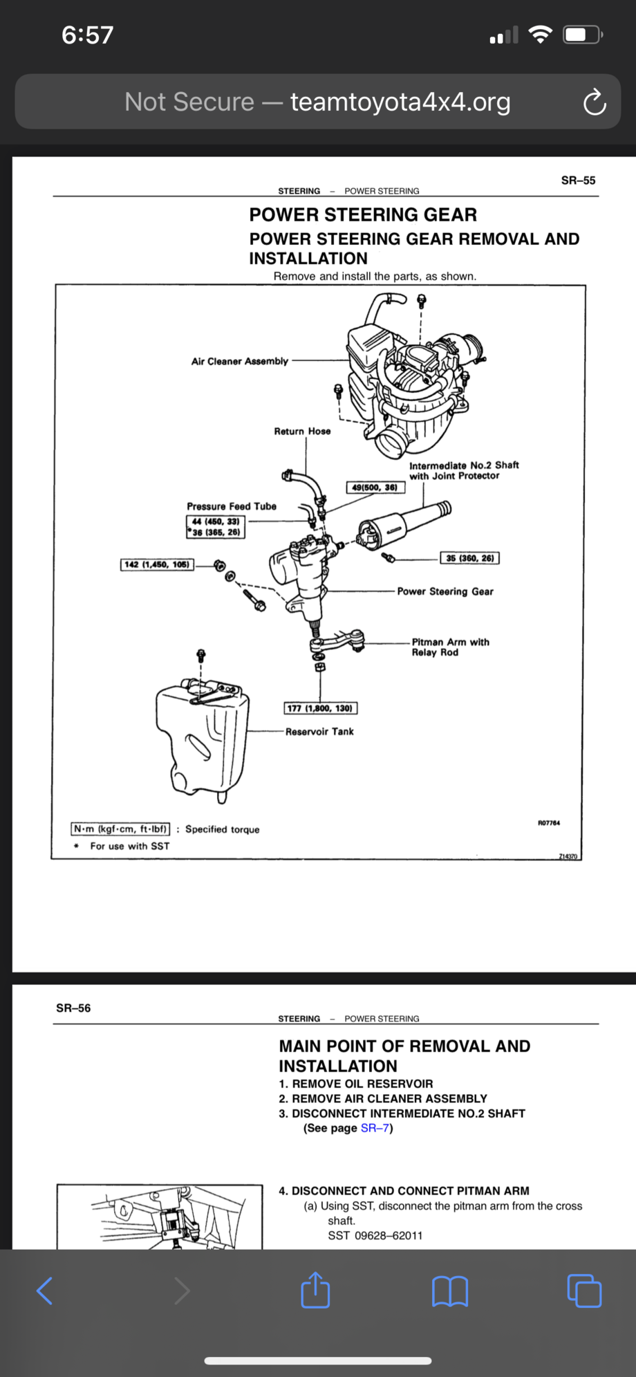

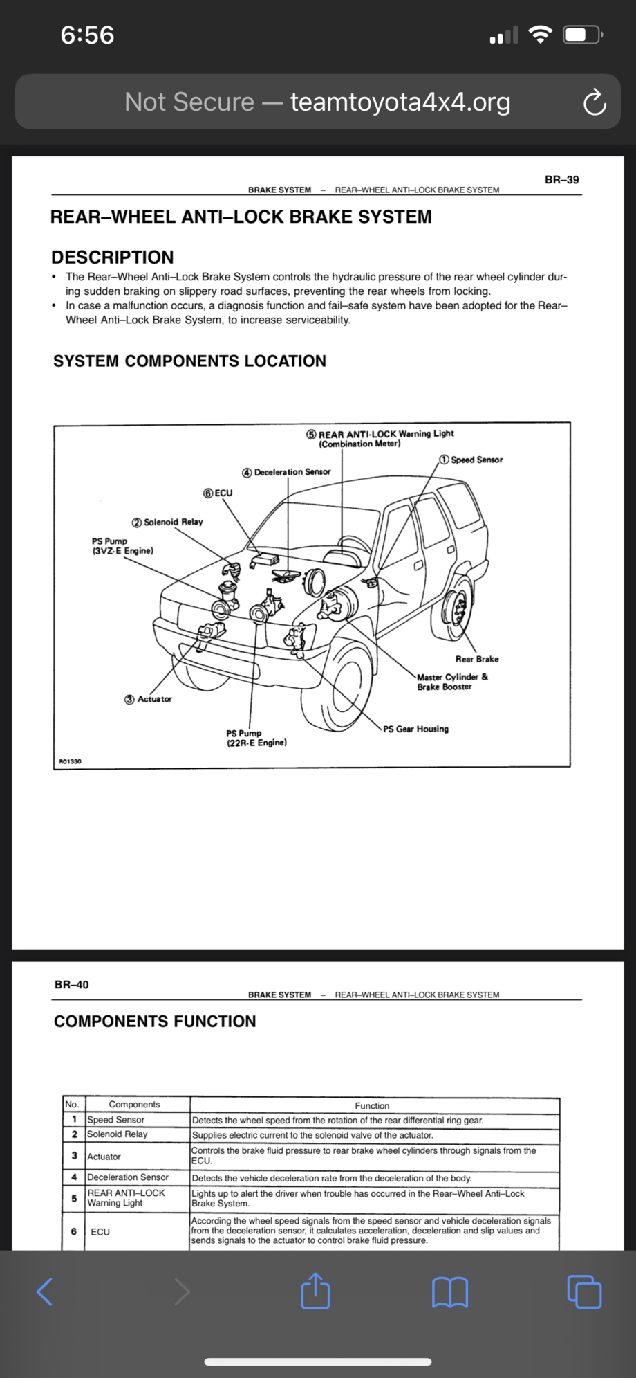

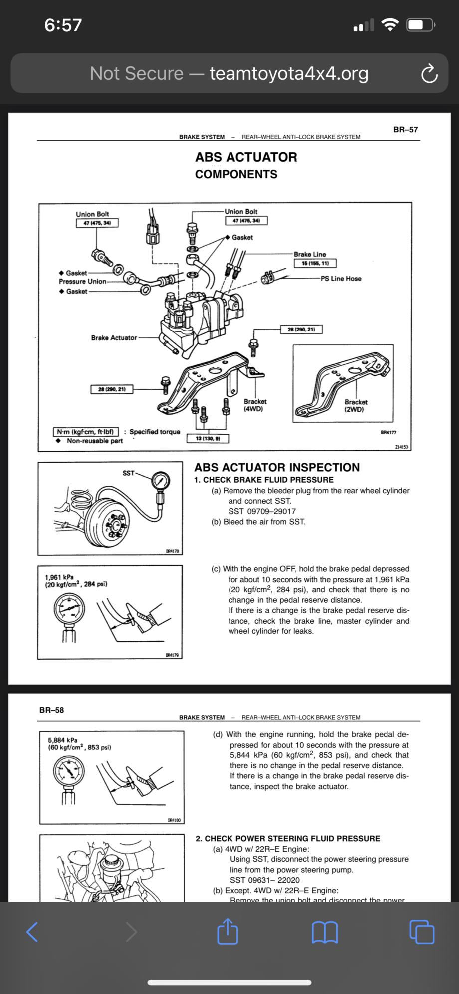

Hi everyone! I have a 95 automatic 3vze 4runner, and want to learn all I can about it. In my process I’ve hit something I can’t figure out, why does the power steering pump flow into and out of the rear abs actuator? I looked through the fsm at the diagrams for the brake system, and power steering system and can’t seem to find an answer. Any tips would be appreciated, thanks!
