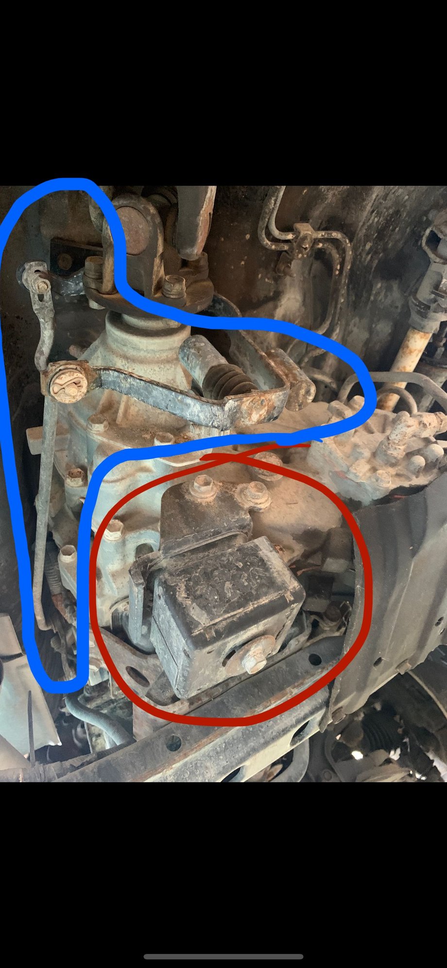

Anyone know what these two components are? It’s in the back of the transmission right in front of the drive shaft on a 95 automatic 4runner (a340h transmission)

These parts are designed to damp certain harmonic vibrations in the drivetrain that might otherwise become problematic.

interesting, do you know the names of them? Or why the one circled in blue connects into the transmission?

I do not know their nomenclature; you might look here::

I’ll look around, thanks for the info this was driving me nuts all day!
