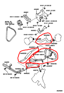

I have a '92 22R 4WD Longbed (rare) and started with the same problem as you: a small, but noticeable leak from the low-pressure return hose, onto the alternator. It did not look serious, so I just wiped it off occasionally and had no probs.(1st mistake) When my brother borrowed the truck (2nd mistake), I showed him the leak and how to wipe off the alternator and how to top off the fluid every now and then. He decided to employ a labor-saving strategy. Tie a rag around the hose to soak up the leak. (Do you see where this is going, everyone?). The rag got soaked and started dripping onto the alternator and the exhaust manifold, which of course started to smoke. My brother then took the truck to Jiffy Lube (3rd mistake) where they sold him a complete service and helpfully removed the rag. 2 weeks later enough fluid leaked onto, and into the alternator which promptly shorted out, taking the charging circuit with it.
The short end of it is, for a lousy $1.99 / ft. + tax (1ft. needed), I could have avoided having to spend much more. I finally ended up replacing the alternator and all the (original) power steering hoses as a set. There are 4: 1. high pressure line 2. low-pressure return from pump 3. low-pressure from reservoir to cooler tube 4. low-pressure from cooler tube to the steering gear. All clamps replaced as well. Total cost $115.00 + $1.00 for a used 80amp alternator fuse from Pick-and-Pull. Aftermarket hoses cost about $20.00 to replace all 4. The Dexron to fill the system cost more than the hoses! Anyway, as the title of this post says: "lesson learned the hard way".

Old Jan 8, 2018 | 08:23 PM
RAD4Runner's Avatar
Joined: Mar 2012
Posts: 7,125
Likes: 681
Originally Posted by dlx92longbed4wd
... "lesson learned the hard way".
Jiffy Lube is the worst mistake
A friend at our office told me of a power steering leak on her Camry and that a shop asked her to come back so mechs can look at it. I looked at it during 15-minute afternoon break, found the stock hose clamp on low-pressure reservoir hose, replaced it with spare worm-gear hose clamp I always have in my tool box. Shop could have easily told her her power steering pump was leaking and charged her for that.
