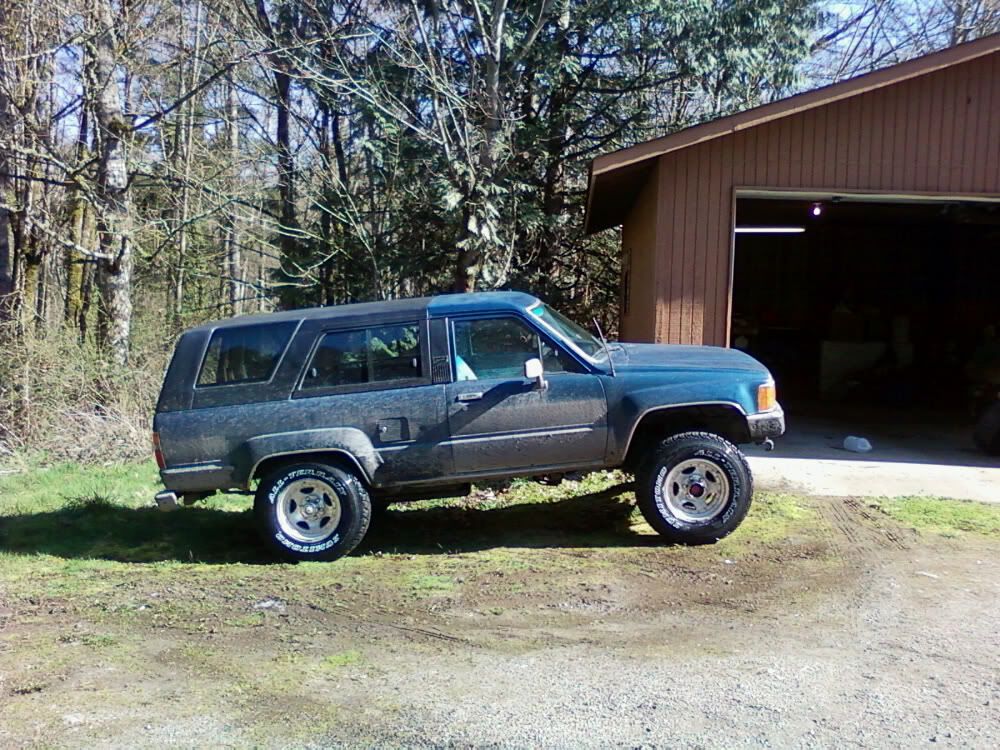

Well I ended up getting BF Goodrich KM2's 33x10.5. Here is some pics. I'm happy I got the 33's instead of the 31's. I just replaced the worn out coils last week. Much better.

So this is stock height or is it lifted with those new coils???

It's stock height. The coils just took it back to factory height in the back.

Perfect....any significant rubbing on the tires?

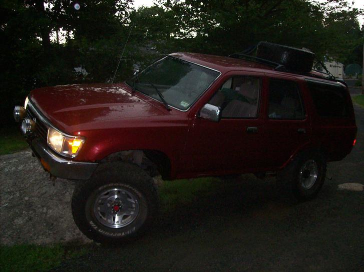

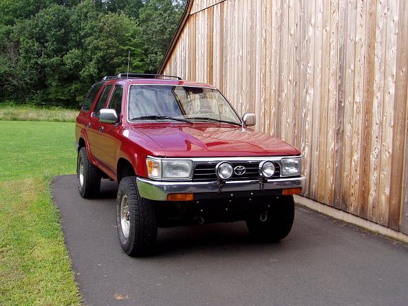

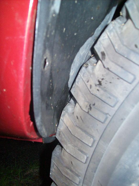

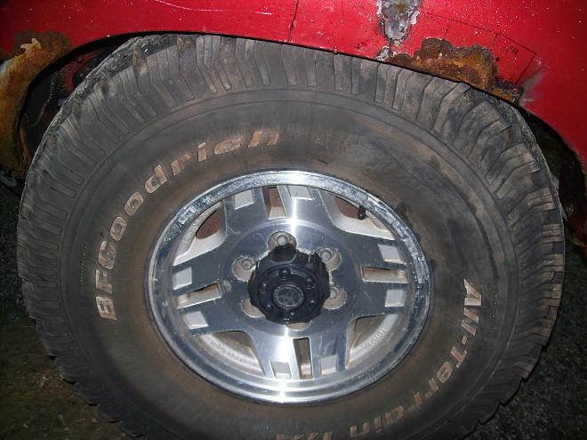

Just wanted to share some pics of my (recently sold) stock height '94 4runner which I fit 33x12.50x15's onto with stock rims. Only had the most minor rubbing on the plastic inner fender well and only on the drivers side. Trimmed that very slightly and ziptied it in place and problem solved. I had already removed the front valance for a better approach angle. Also that was on the stock rims (15x7?) and I ran them with no problem for a good 15K miles.

No rubbing yet.

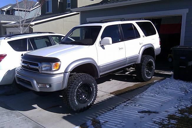

Well, thanks for the info. I went ahead and went with 285's instead. Better gad mileage, lower price, blah, blah, blah. I went with the Duratracs. They look pretty good and should work great for what I need em for.
