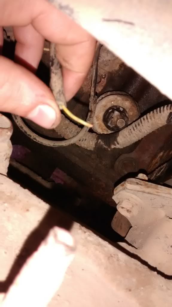

I'm basing no oil pressure on the stock gauges. They worked fine before the oil change. I'll definitely check the sensor.
Size:  56.5 KB. Is that the broken sensor?

Yep. Looks like the wire lost the clip.

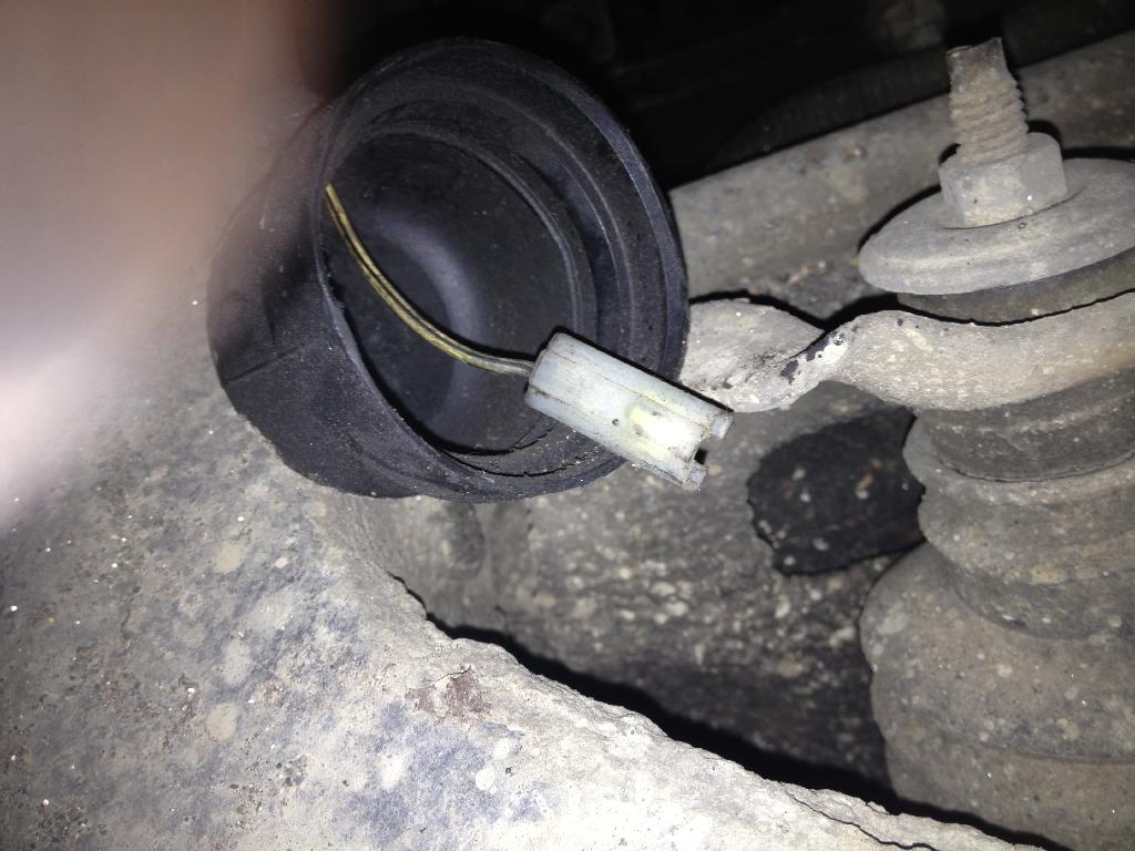

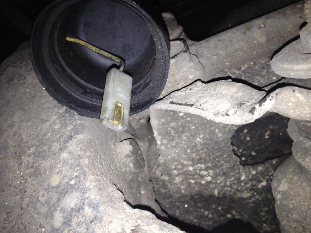

Well, it's a funky square clip that goes onto either type of sender. Lemme get a pic of mine so you can source one, or engineer a temporary fix.
It just slides over the top of the button, parallel to the block, if you have a gauge. For an idiot light, it goes on the blade, at 90* to the block.
Maybe you could modify a female blade to fit over the button? It should have a harness connection 4-6" up the wire, you may find a whole new end in a JY or somewhere.

You can modify a standard female crimp on connector to work. Enlarge the slit in the bottom and it should slide right on.
