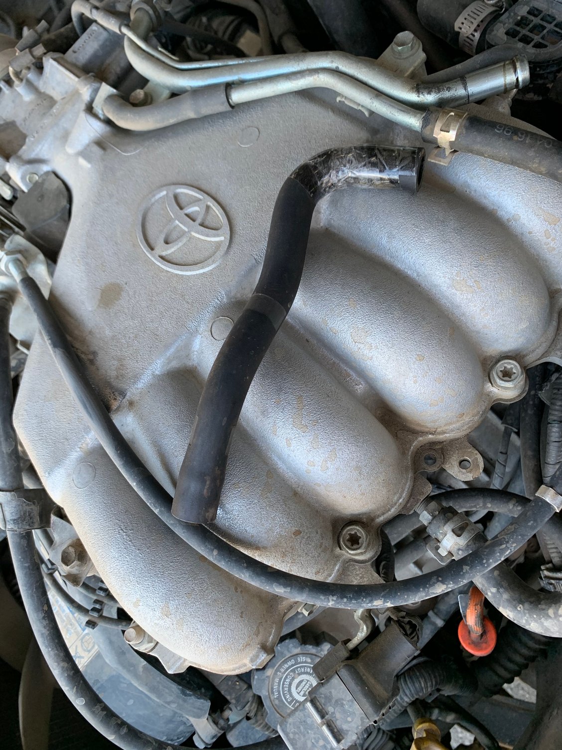

If anyone knows what hose this is or has a part number for reference that would b great yea. Winner gets a truck air mattress.'LUOOV Multifunctional car suv matress'

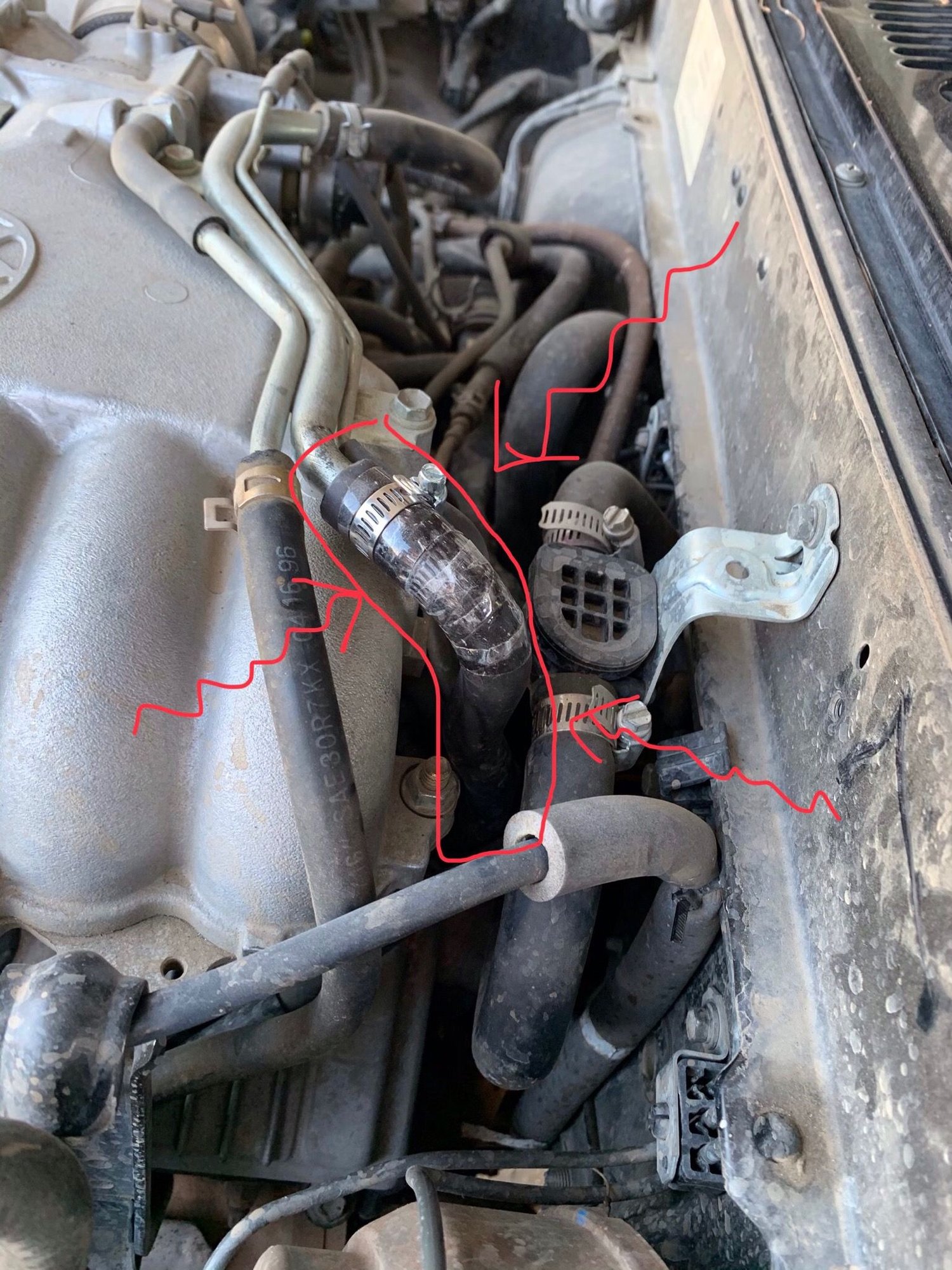

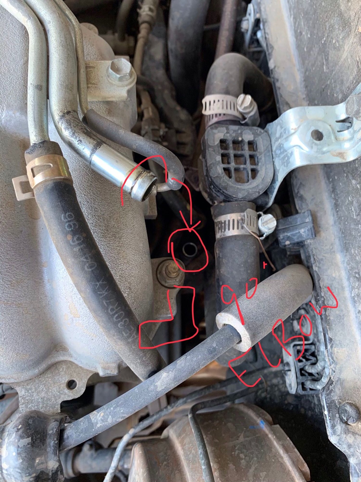

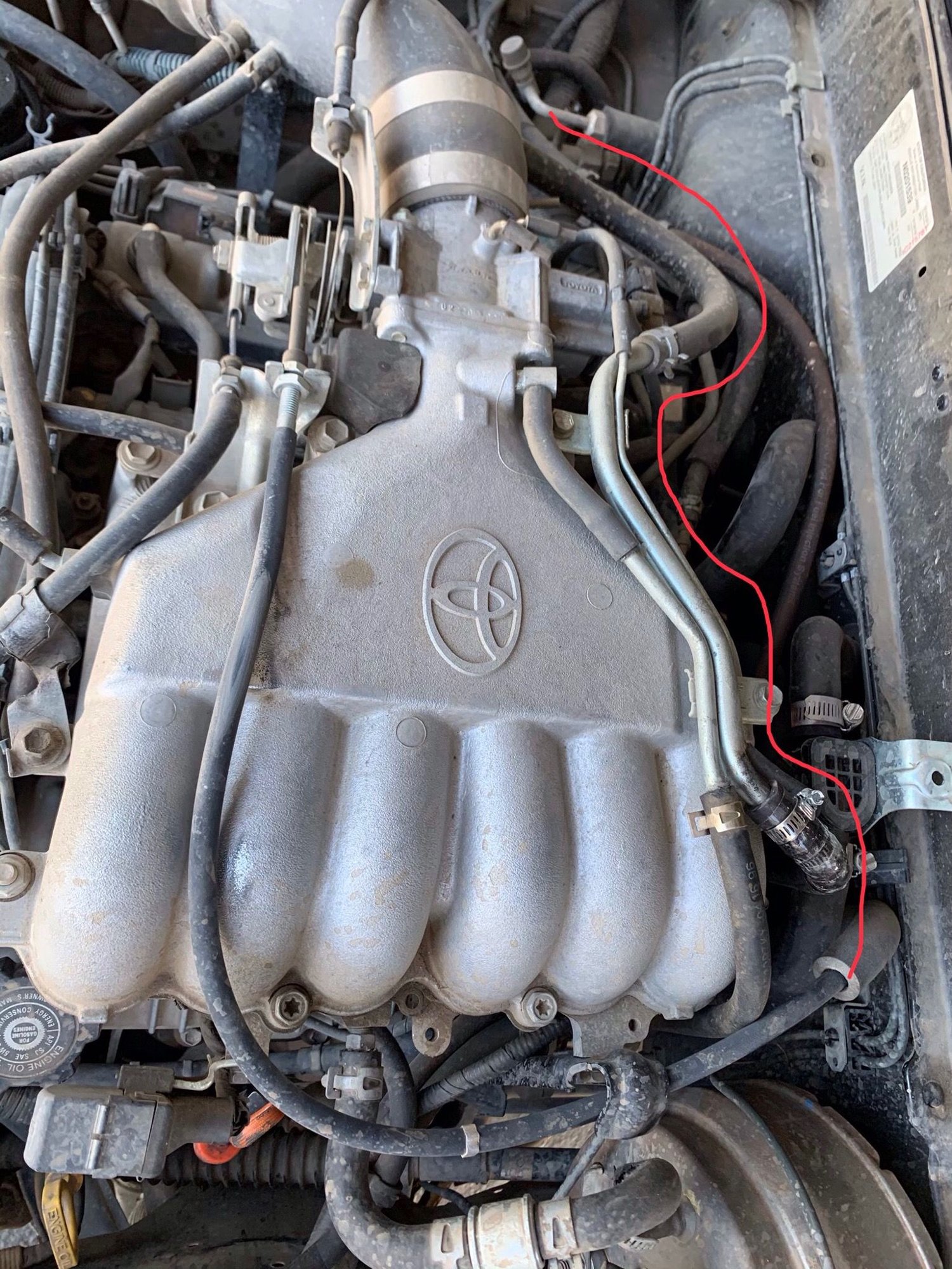

This hose runs from the rear of the engine, connected to the cylinder head- up to a metal line on top of the intake- runs across and connects to the air intake line.
Evap system?
Egr system?
toyota dealership could not find.
3.4 from a 98 t100

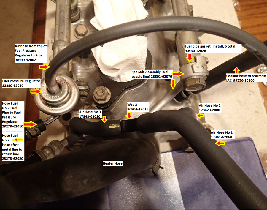

I'd give you a prize for year/model/looks like a 3.4?
Try finding it on this site... https://toyota-usa.epc-data.com/
I've got these numbers, but it's off a '96 4Runner-thinking you have something different-
Not pictured- the forward IAC coolant hose to pipe (not attached to intake manifold but to the pipe behind it)- part# 16261-62060

habanero! thanks so much for that site! found the part, i think. Crankshaft breather tube. 12262-62050 is anyone is interested. PM me if u want that mattress
