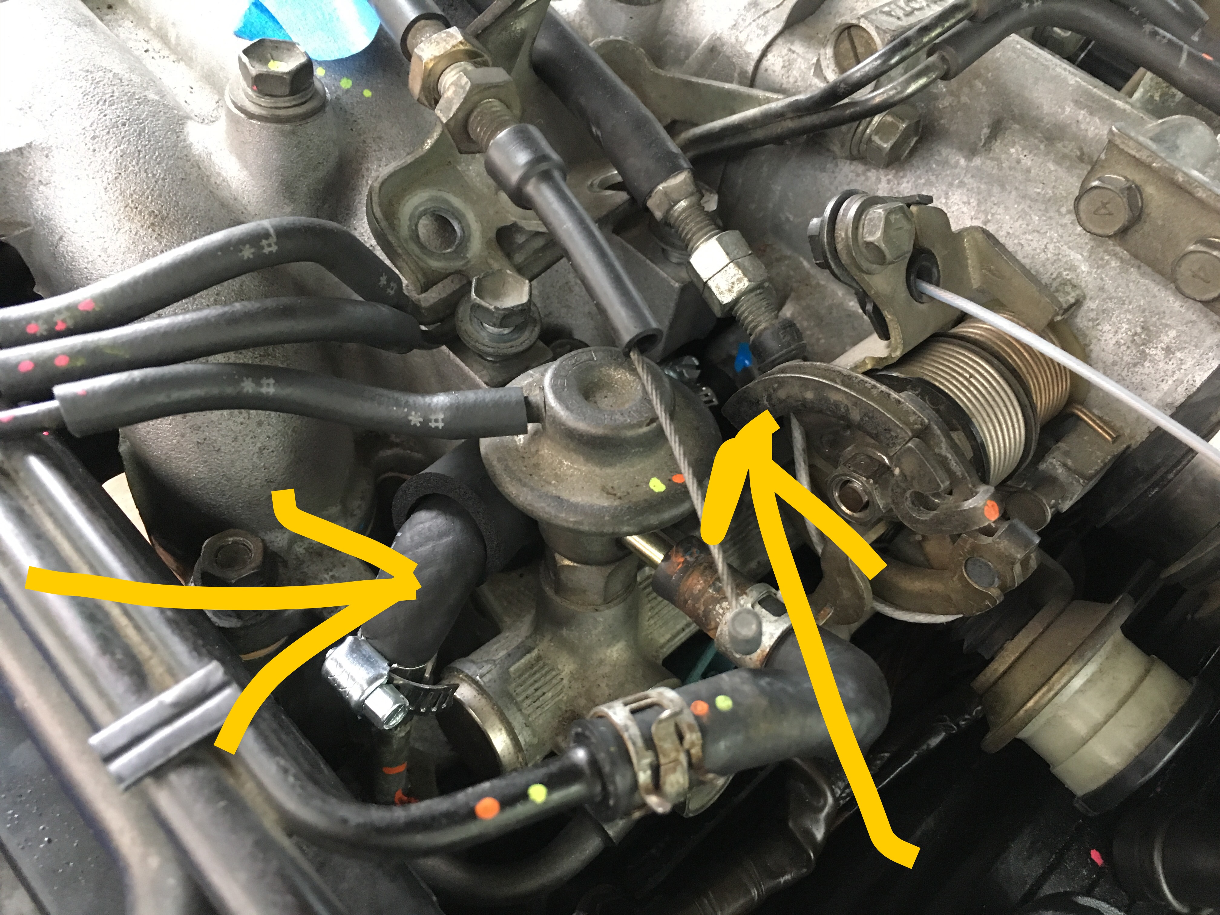

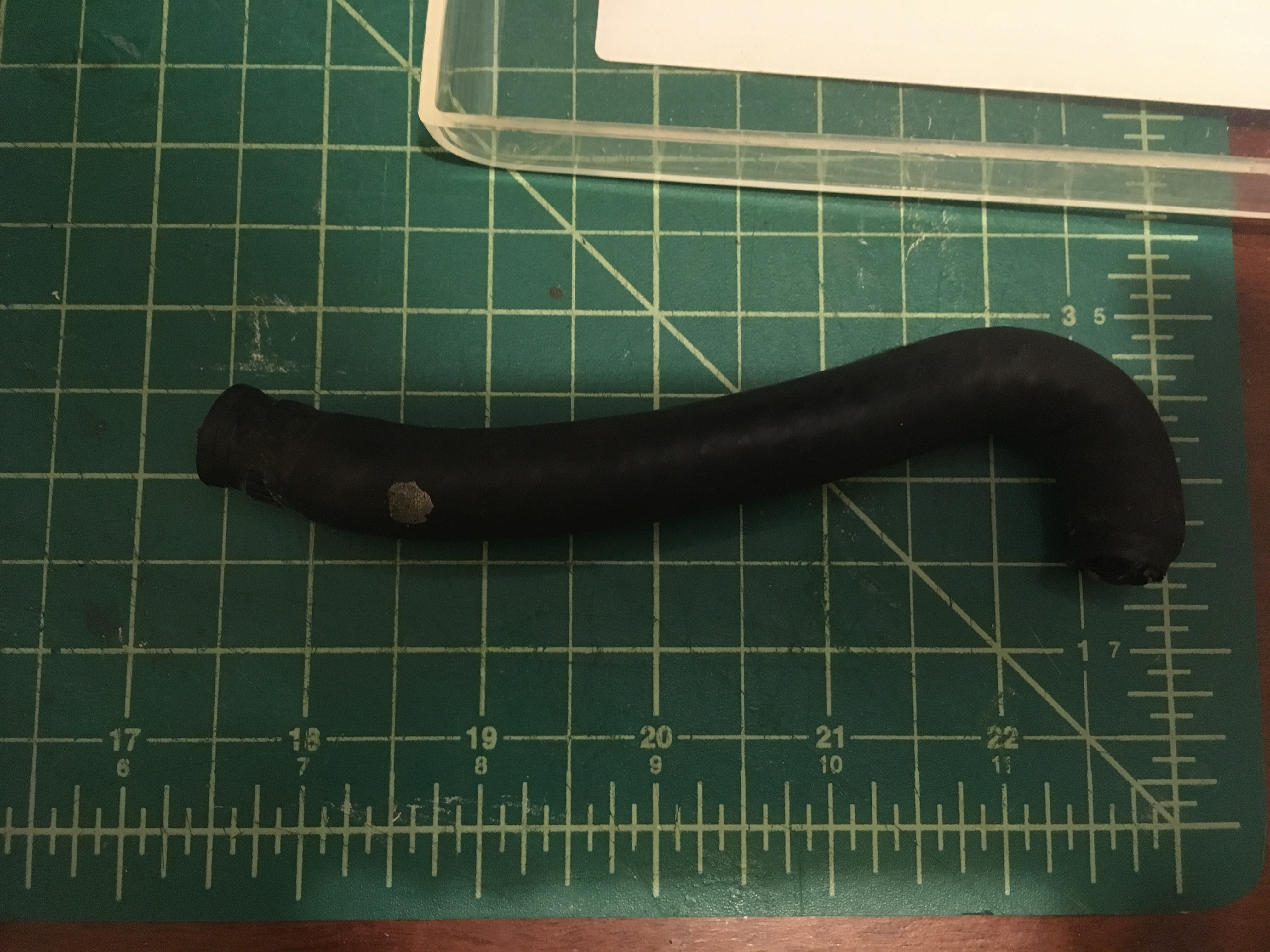

Since you're so good at this I've got one more for you. I think this one helps move fuel around. In the photo you can see the universal hose I replaced it with...its got a good bend to it though and I don't think the universal stuff can handle it. The arrow on the right is showing where is ties into the engine underneath the throttle and marked with a blue dot. Its about 6 inches long and the inside diameter seems to vary.
After doing VCGs, Intake Manifold Gasket, PCV Valve, and spark plugs/wires, my engine is idling really rough. It seems to be fine when accelerating although when I accelerated harder once I got a squeak/quick squeal. I think getting the proper hose in is going to be the first step in chasing down the rattling. Thanks for the help!

Your hose is for coolant (it warms up the throttle body). HOSE, WATER BY-PASS, NO.4 Part Number: 16281-65010
http://parts.lakelandtoyota.com/p/TO...628165010.html
