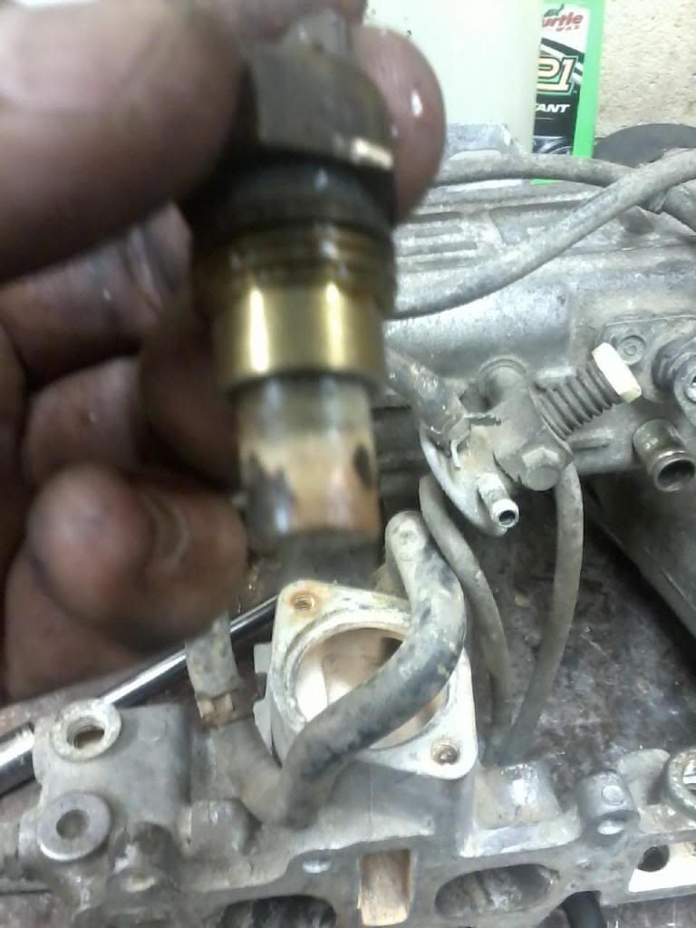

I agree with the Termostat that has been mentioned, but since we are on temperture gauge issues, I wanted to add another problem and fix that I ran into.
A while back I was mentioning that my wifes truck water temp guage was going from half way to cold. I actually forgot about it until I drove it today and it did it again. I pulled the water temp sensor and it had green corrosion on the sensor cleaned them with a brass wire brush and then I cleaned the contacts that goes to the wire as well with electrical contact cleaner. No more problems. Stays just below half as it usually does. I knew it wasnt overheating, but still like having a guage.
Here is a picture of a dirty Temperture Sensor. I have seen worse. I chipped some of the scale build up off so you could see a difference.
The sensor sits just below the Cold Start Injector in the Intake manifold. Uses a 17mm deepwell socket and is a 5 minute job.
