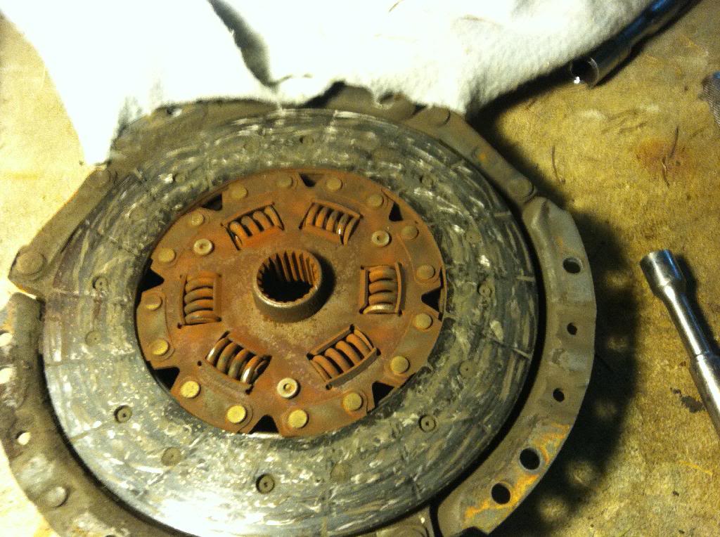

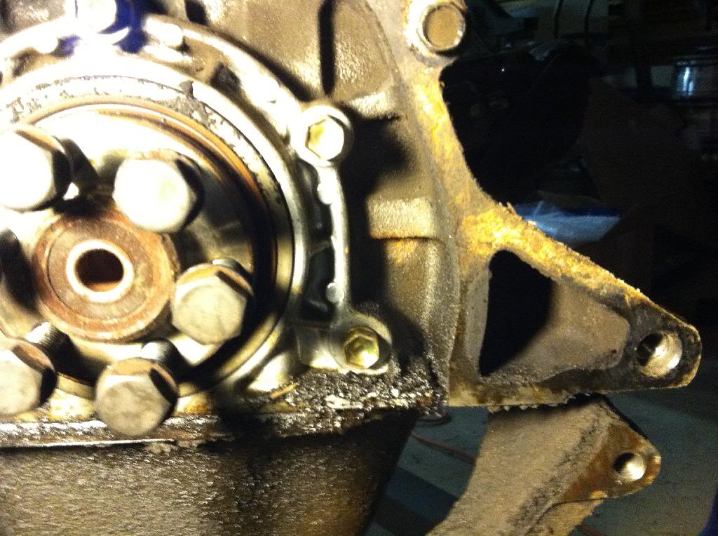

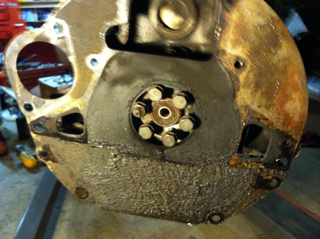

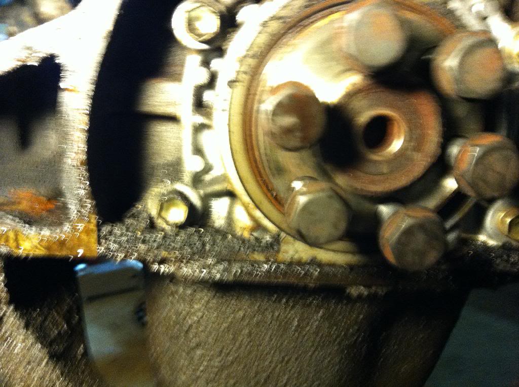

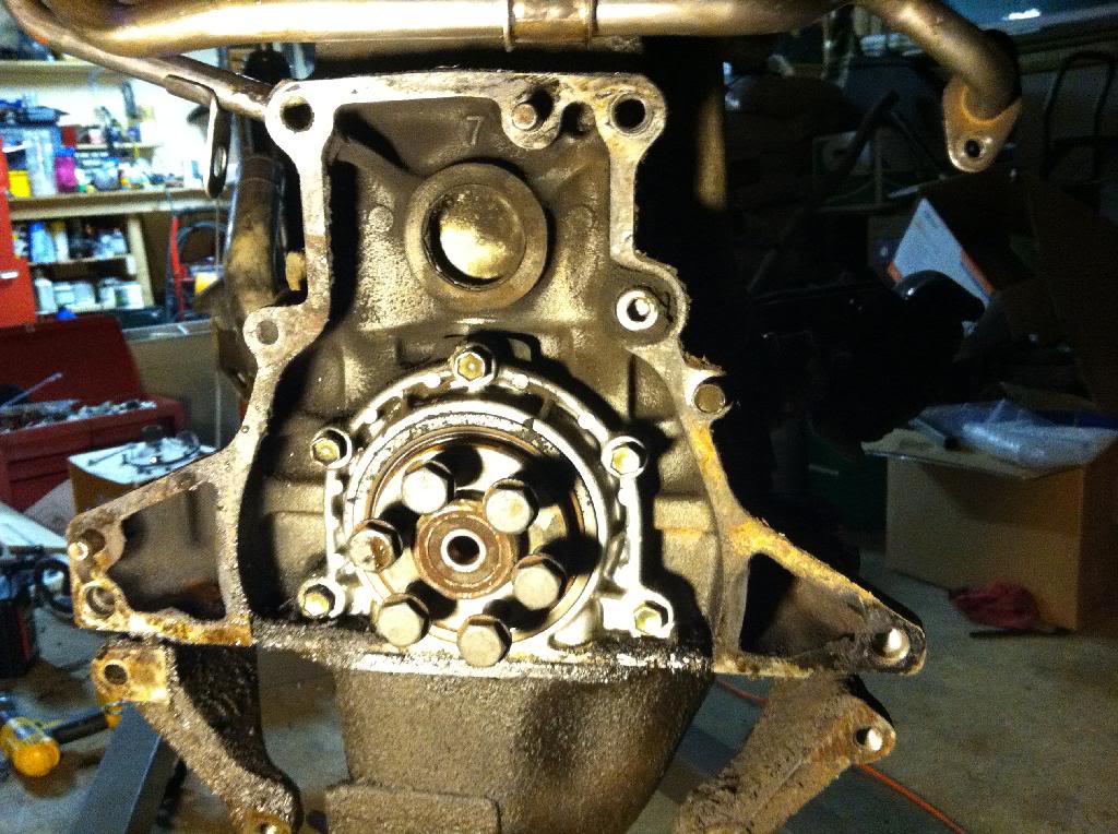

Ok bought some hydraulic fluid and the picker worked great again. Got my old zero compression motor pulled and wow rear main leak smoked clutch the works.

Now I need to have that flywheel ground and install my new clutch. Clean the bell housing. Replace that bearing and the pilot bearing and bolt it back together.

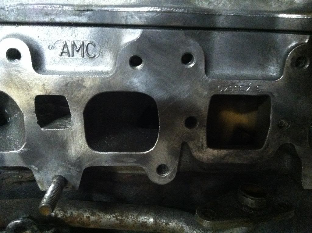

So got to degreasing my new motor and after I pulled the intake off I for a different stamp. Looks like I have an after market head. Is this a good one or just a head. I guess what I am asking is this worth porting and such in the future. Or should I still just plan on buying a head from engnbldr and either gaming him port it or do it myself. I have some basic knowledge on porting. FYI. Name:  C483571F-4360-4808-994F-D91E1C8B9801.jpg

Anyone know what the AMC on the head means?

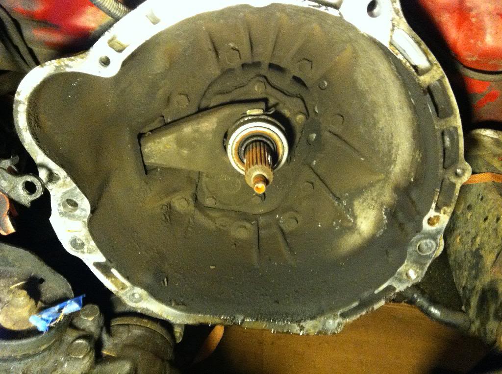

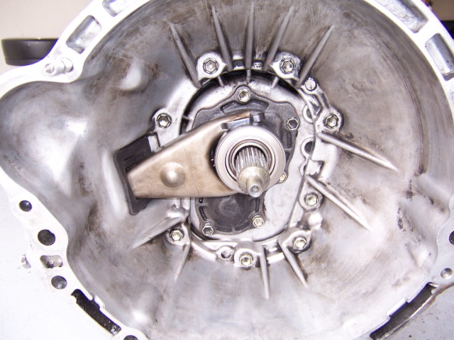

Ok what's the best way to go about cleaning the crap from my bell housing.
[Name:  B9CC9FD4-EDEA-48C6-9365-3DF57959739E.jpg
Can I just use a degreaser and hose it out. Not sure i should spray water in there. I am going to replace the throw out bearing but still nervous about putting degreaser or water in there. What do you all think?
Thanks

Simple green, let it soak a bit. ( or any other degreaser ) Then blow out with water. They're not really designed to be submerged extensively, but if you can ford em thru a creek, little pressure washer action won't hurt.

my guess is that all of the 22re heads you'll get are aftermarket, unless you possibly go to the dealer for it... the head that i got from engbldr says dmj, or something similar, not amc, fwiw.
Thanks

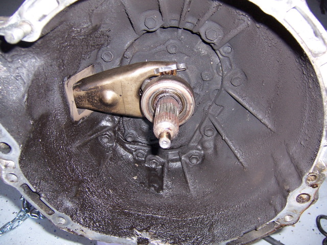

Don't worry about using degreaser to clean the inside of the bellhousing, I usually use brake cleaner and a brush to clean mine and have had no problems in any of the trucks I've had.
before
after, with a new throwout bearing...
