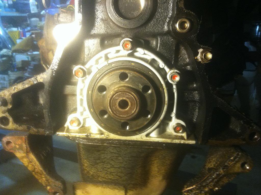

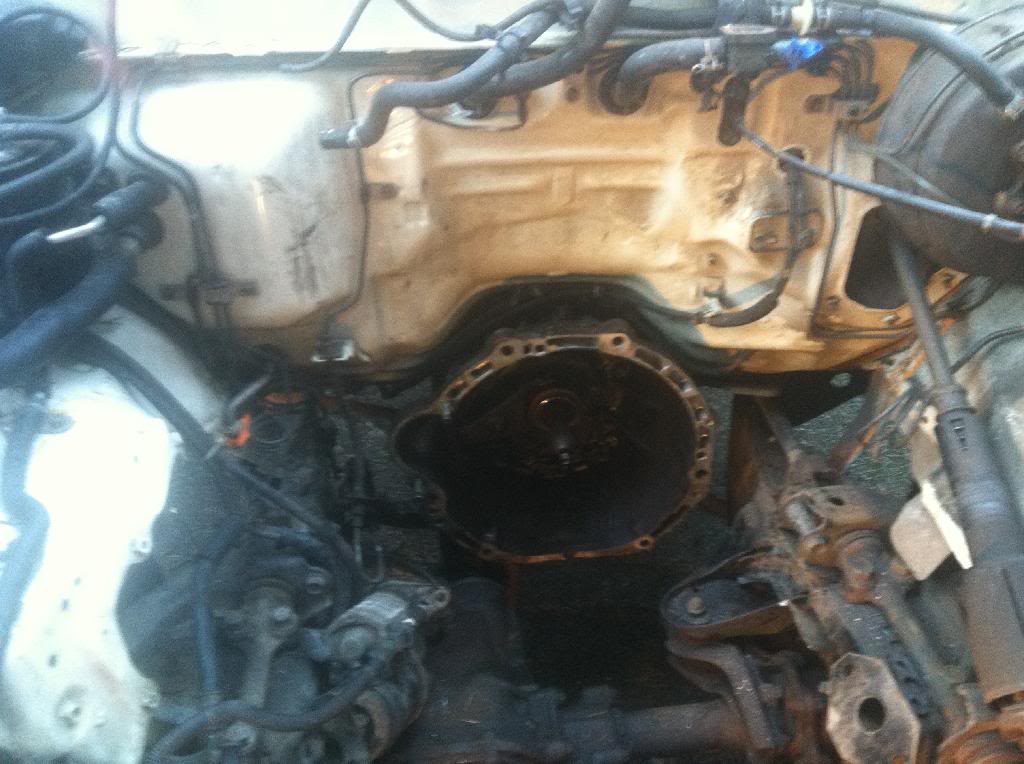

Ok got my parts truck motor pulled today to do the long block swap
Pulled the old clutch and fly wheel off. The fly wheel looks good. Only 40k on it. I don't think I need to resurface it. Is it stupid not to? But how do I change this bearing on the rear main seal?

Do I have to change the rear main seal? Is it a pita? Can I use a parts store gasket or do I need to order a oem quality one? Or am I just am idiot? Wait don't answer that last one.
Let me know if you need better pictures.

I'd resurface it, you already have it off. You need a puller for the pilot bearing, I've seen it removed other ways too. You don't have to change the rear main but I would while it's apart, along with the trans input seal.

Just trying to get it done this weekend. I will see if i can find a machine shop open this weekend. What type of puller do I use? Probably the only type I don't have. Typical. If the ream main only has 40k on it should it still be replaced? Money is tight right now. If I have too I will but just trying to save a buck or two. And time. Big time on the time.
