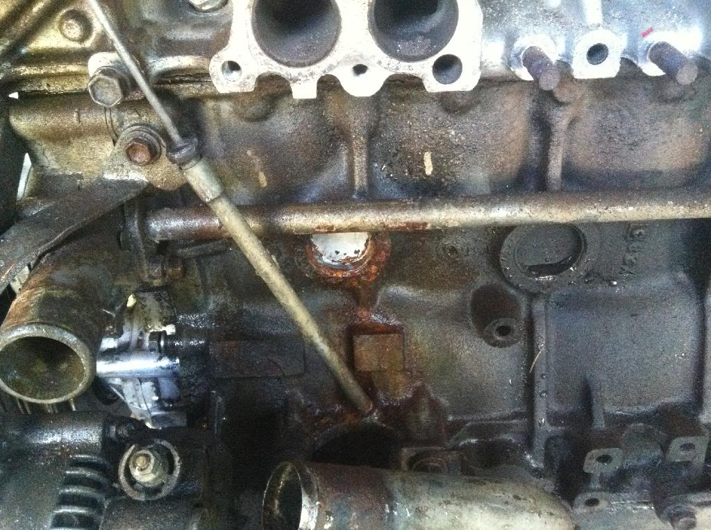

Ok I am going to hijack my own thread. Ha. I dragged the donor motor out to give it a good cleaning. The whole front of it was covered in oil. Could have been from the half moon gaskets. I know the back one was leaking. So that probably is nothing to worry about. But when I looked at the drivers side there was rust in a place where I didn't think there should be rust. Right above the dipstick. I took a small flathead and most of it flakes away to what you see in the pic. But it was covered.
What do you all think.

It looks like the freeze plug is/was leaking. Might as well replace them as well. It sucks spending money on all the little stuff now, but it's a lot easier than constantly working on things after it's running.
