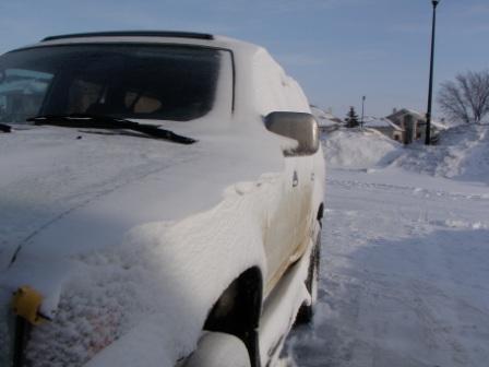

A few Pics
Its a 95, 3.Slow, V6. A couple of terrible pics of her, the skux deluxe. She's more of a summer creature, but she loves to get sideways in winter. Hence no lift suggestions please.

Tofer's Avatar
Sponsor
Joined: Jul 2004
Posts: 9,173
Likes: 6
From: Puyallup WA.
95 will have coil springs in the rear.....
Looks like a 4runner if so then you have coils not leafs unless someone did a rear conversion. If it is coils then you need to get either
A. New coils stock size or if any kind of lift a set to match the lift.
B. coil spacers could help you out
both options are no more then $200 and if you put them in yourself that's all it will cost you.

It definitely has Leaf's in the rear. Its registered as a 95, possibly different to the US 4Runner. No one works on my vehicles but me so i just need the best option. Its finally warm enough to work on it, so its getting some love at the moment. New rotors, pads, rod ends today, new CV's and rear axle seals, belts, plugs and leads yesterday.

Find it hard to believe it's leafs, unless it's already been converted, as stated above. On my 92, a set of Moog c-255 coils from the local Bumper to Bumper brought it up an inch or so to level.

do you have any pics of the springs?

I put Moog C255 coils in my 95 4Runner. Raised it about 1 1/2", just enough to straighten it out. Less than $100. Added four Rancho 5000 shocks; good enough for snow and light off roading.
No, it has coils unless someone modified it. Canadian 4Runners are the same as US, only difference is the speedometer is in km/h, and you have daytime running lights.

I also doubt that there are leaf springs back there, unless someone did the conversion.
Personally, I love my OME's with the Nitrocharger shocks, but you're looking at close to $500 Canadian to do it.

Pics of the rear springs to settle this dispute.
