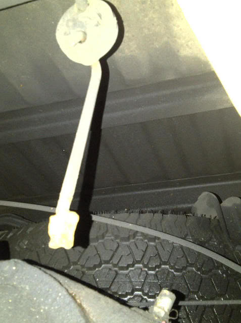

  #59
cap85's Avatar
Joined: Mar 2012
Posts: 128
saw this hanging there...whats it for?
Old Mar 31, 2012 | 02:57 PM
  #60
4Crawler's Avatar
iTrader: (3)
Joined: Jun 2002
Posts: 10,822
Likes: 34
From: SF Bay Area, CA
Looks like the factory exhaust/muffler hanger.
