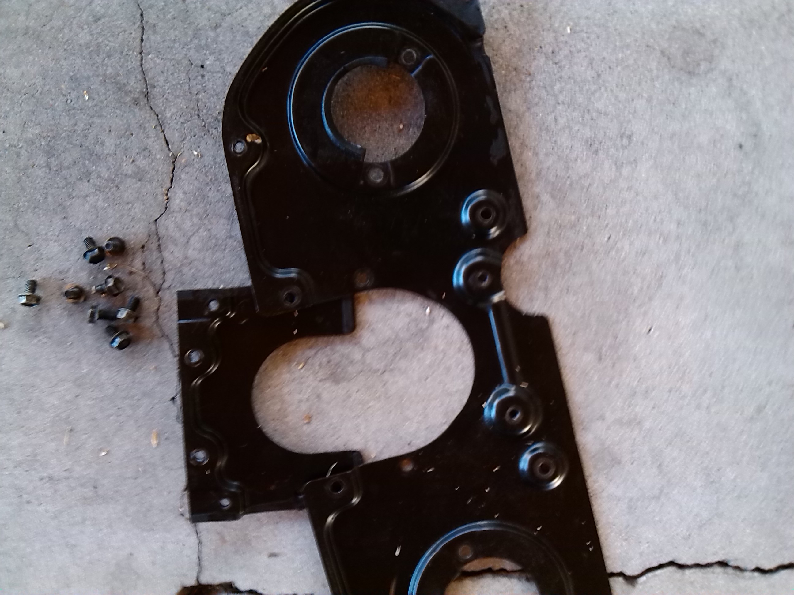

Putting back essentials
Is the plate that sits behind the Lh & Rh timing section considered to be essential ?
Attached Thumbnails I'm new to this - 3vz 3.0 trouble removing crankshaft gear-img_20140627_160849.jpg
Old Jun 28, 2014 | 07:37 AM
  #28
2toys's Avatar
Joined: Nov 2012
Posts: 111
From: santa cruz, ca
Yes you don't want crap falling down inside the timing cover from behind unless you like replacing t belts. If an extension or socket fell in there (when your inevitably working on the 3.0 in the future) it wouldn't be pretty
The cams TDC timing mark is on that cover plate. Re-install it.
