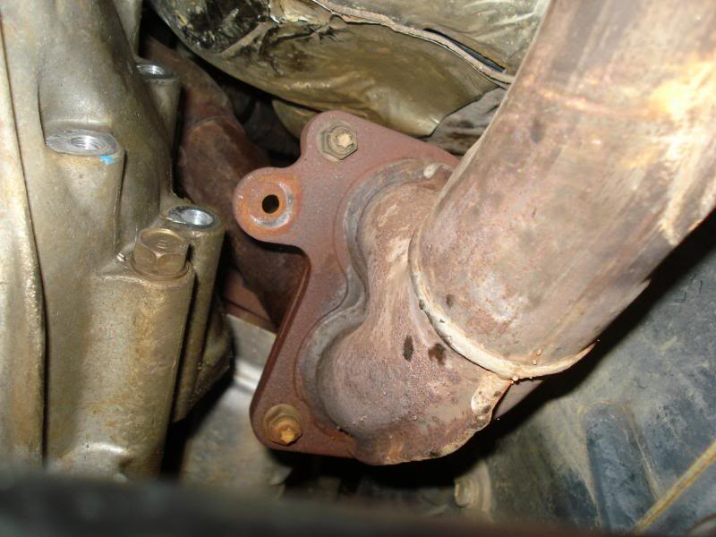

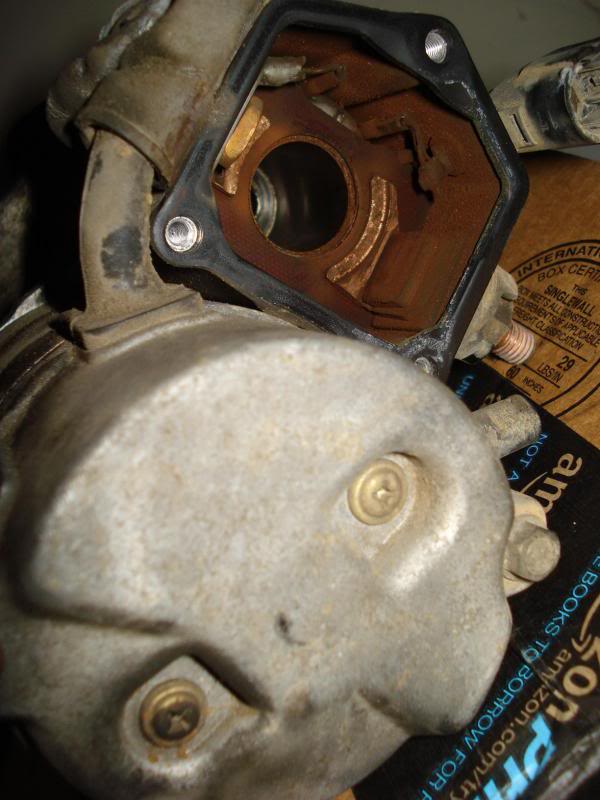

The 99 4Runner was refurbbed. There is an exhaust bracket in the way of one of the bolts that goes through the bell housing. The way that the 99 3rd gen Runner starter is secured is easier than the 3rd gen pickup. 4Crawler has saved another Toyota for my family to drive.
