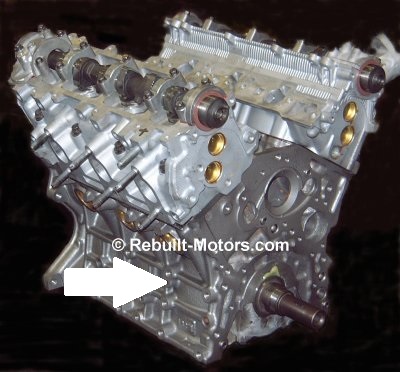

Kiroshu's Avatar
Joined: Oct 2007
Posts: 2,747
From: NC
^-- This general area..?
Unless its leaking from the cylinder head gasket there are not a lot of items in this area...
Is the leak higher up...?
Does it seem to leak from the timing cover area...?
Its possible that one of the multiple coolant hoses/pipes in the valley of the engine have a slight leak and the coolant is making its way down the center of the block and down along the sides of the engine....
Intake manifold gaskets...
Water pump...
Timing idler pulley coolant passage...
There are 2 plugs at the front of each cylinder head as seen in picture.
