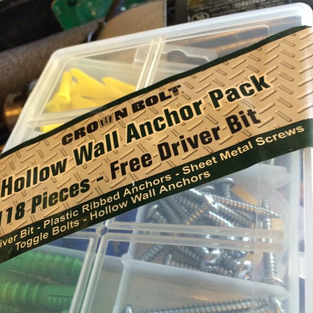

Geeze I can't believe this is a thread either. When I have a non structural part to reattach I use stainless screws. I got a big pack of them at Home Depot. For the plastic nutsert part I clip about 1/4 inch off the tip of a plastic drywall anchor.

They are just screws. And the drywall anchors are a great idea.

It is in the Newbie section some of us like me are not that gifted when it comes to mechanical things.
I try and learn all the time.
like the dry wall anchors good idea!!

[QUOTE=Nervo19;52258472]"Geeze I can't believe this is a thread either. "
[/QUOTE}
OP, I apologize. You asked in the right place. Welcome. I am the queen of stupid questions so I have no room to criticize. One of my taillights is held in by a drywall anchor because the Toyota plastic had no more hold left. I've used them for license plate screws as well. You have to clip them short so they don't interfere with the rear window of a 1st gen 4Runner.

Good tip, Nervo19 for the idea about drywall screws into nylon anchors, I'll remember that for future reference!
