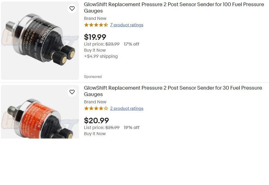

I see cold start fuel injector mount gauge fittings for around $20 on Amazon and Ebay....and small gauges are another $30-45 ..but, yes, a sender would be the way to go....just screw it in where the gauge would go on the fuel rail and use an electric gauge in the cab....

These senders look interesting;
Ad Indicates it works with many different gauges

there are cheap gauge options if ordering from china, for instance sender+gauge for around $35 or less.
