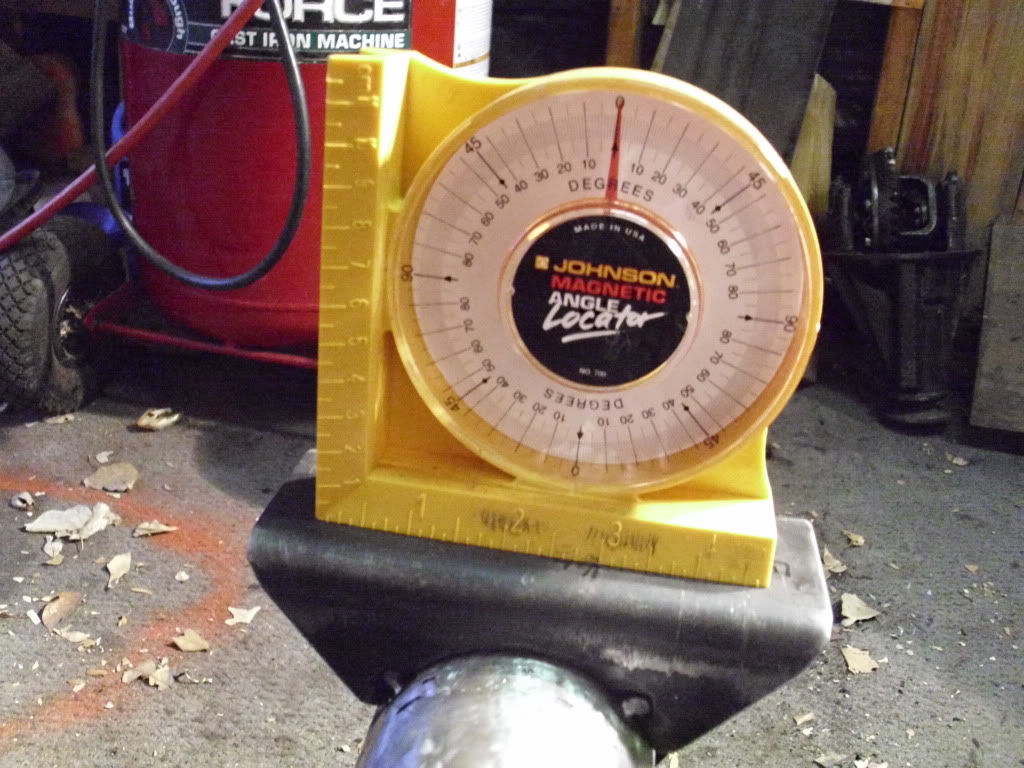

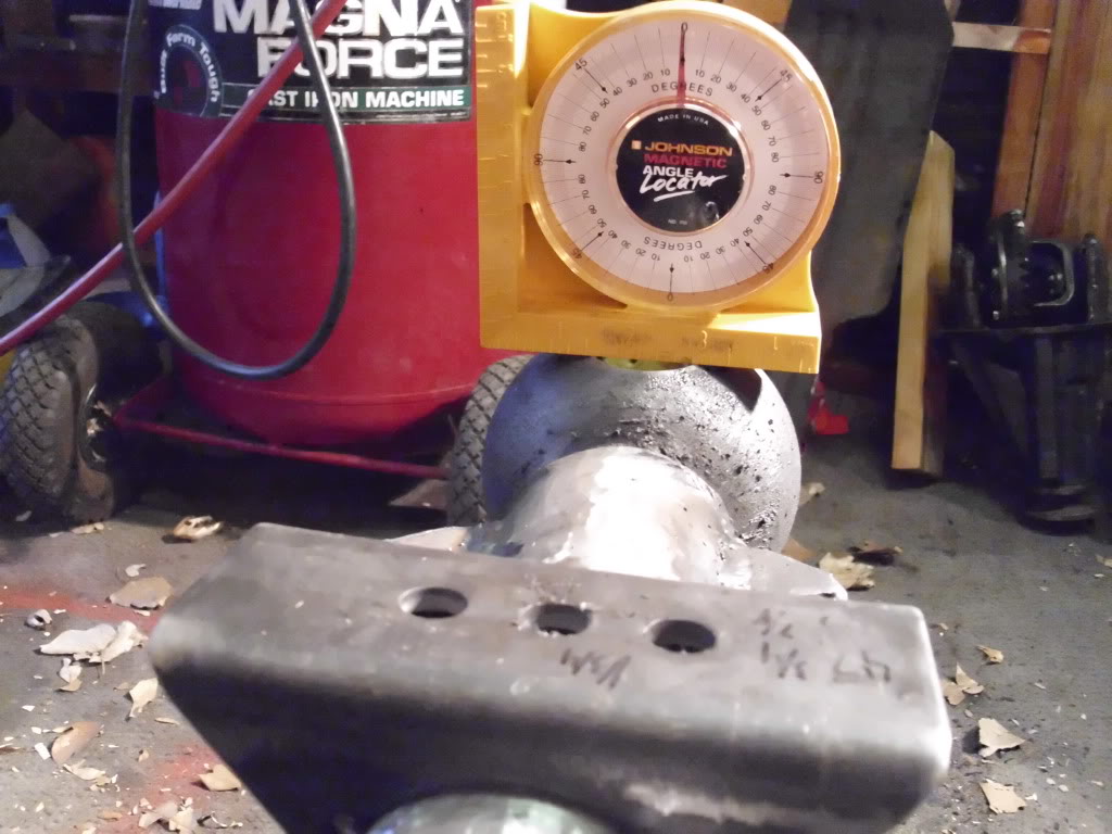

I accidentally welded my new spring perches on the front axle parallel with the steering knuckle race holes.
I'm wondering, 4crawler, if you can tell me what shims I need to correct my caster? I get terrible death wobble at 45mpg right now. I've been planning on buying some lift blocks from you as well, but these are my priority right now so I can drive safely again.
Old Feb 10, 2012 | 07:26 PM
4Crawler's Avatar
iTrader: (3)
Joined: Jun 2002
Posts: 10,822
Likes: 34
From: SF Bay Area, CA
See below for a quick measurement to you take to get an idea:
- http://www.4crawler.com/4x4/ForSale/Shims.shtml#FAQ1
Not sure what all you did to the axle, but if the knuckles have been moved, then the above reference measurement may not be accurate. In that case, have an alignment shop check the caster angle and tell you what it is.
