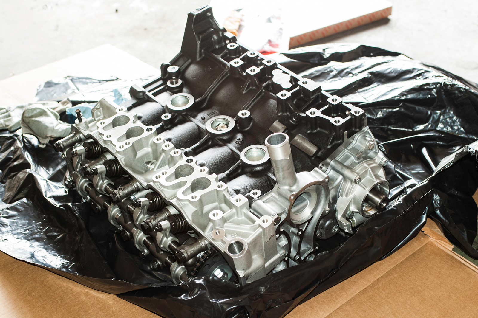

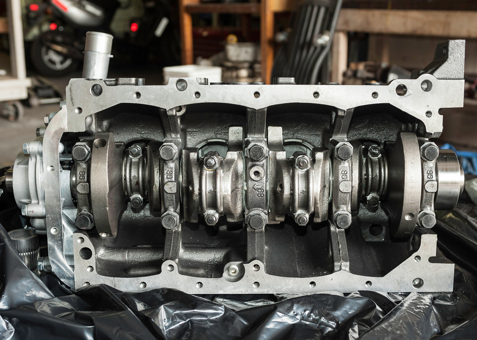

I've Got One - Brand New 22RE
I considered starting a new thread for those who have these engines, but then found this one. I also am curious to hear from others who have these engines. I have not been able to find much in the way of reviews, apart from the 2 good reviews on their website.
http://www.toyotatruckengine.com/bra...-all-new-22re/
I've got one of these engines in my '86 4Runner, installed it myself mid-2014, and so far so good. It replaced the original engine that has about 400K miles on it. I've got about 3500 miles on the new one now, not so many because the rig has been down for other stuff since (rebuilt transfer and 3rd).
I got it directly from the Colorado Springs guys, and Luke was the dude I spoke with on the phone. When I got mine I kept the old original engine in case I need it at some point in the future. They only offered $75 for it anyway, not really worth the trouble.
Like others I hounded Luke for details on where everything came from and who was doing the assembly. The impression I walked away with was that they used Japanese parts assembled here in the USA. True or not i don't know. The gasket kit I got with the engine was made in USA. I still have the box and could check that out again, but I recall seeing "USA" on some of the paper gaskets.
I've got pics of the engine, attached to this post. I sized these files down some for posting. The originals are fairly large. I could crop in on some details for a better look at certain details if anyone is interested.
I looked at the block and head castings to see how similar they were before I installed the new one. There aren't any obvious "Toyota - Made in Japan" markings on either engine. The blocks look pretty dang close to me in all the details I looked at. There were little ID tags in the mold, on the sides outside the cylinders, some held in place by screws and others not, and all that ended up being cast into the block - these and other details appeared identical to me. Where Toyota stamped numbers into the block the new engine bears hand scribed numbers. The heads are different, but the new head looks like the casting on a pal's early '90s 22re.
During assembly I noticed that everything fit perfectly, manifolds, brackets, etc. You can also see balancing drill marks in the crank. The only problem I've had with it is that the rear main seal started leaking almost immediately. This was the seal that came in the kit, and not one from 'Yota. When I rebuilt the transfer I replaced that seal with an original from the dealer and so far it hasn't leaked again. I haven't driven it much since then, though, as I've gotten into the rear axle for rebuild and locker install - it's been off the road for a while now.
Anyone else have something to say about these engines? Mine runs great, doesn't consume oil, valves have stayed consistent.
NOTE: After looking at the main bearing caps for the crank I notice that the new engine's caps lack the "W" symbol I find on the original engine's caps.
