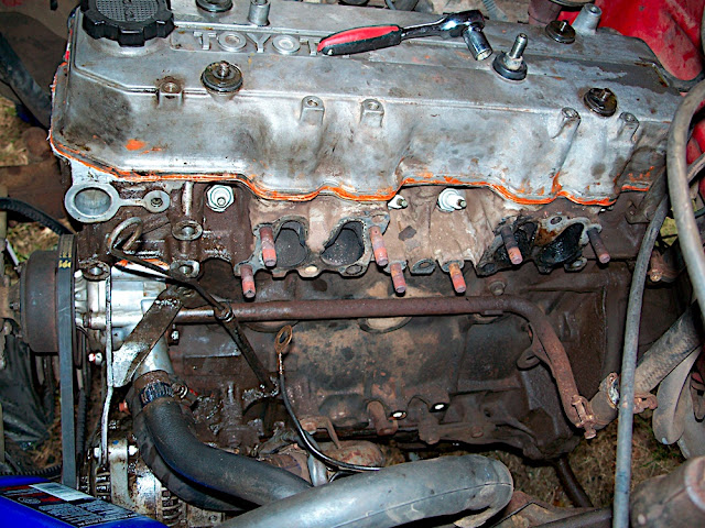

From: Haiku, Hawaii
Ya that's not too bad for an upgraded head...ready to install.
I wish that I would have just bought the full on rebuild kit with everything for $200 awhile back but all well. I'm about $200 in right now and that was just for the timing cover and timing kit -- even with a 60% discount at Napa it still bites hard...those prices were after the disc.
anyways, i'm about an hour in right now and have the EFI and exhaust off.
That's my plan, i'll check the head and see if it's warped. If not, i'll just go for the gaskets and head bolts. But, it would be pretty cool to do a full on cylinder head job and mess around with things.
http://lh4.ggpht.com/_jkfhE1a6Q-o/S4...0/100_0658.JPG
http://lh3.ggpht.com/_jkfhE1a6Q-o/S4...0/100_0659.JPG
http://lh4.ggpht.com/_jkfhE1a6Q-o/S4...0/100_0660.JPG
http://lh3.ggpht.com/_jkfhE1a6Q-o/S4...0/100_0661.JPG
http://lh4.ggpht.com/_jkfhE1a6Q-o/S4...0/100_0662.JPG
http://lh3.ggpht.com/_jkfhE1a6Q-o/S4...0/100_0663.JPG

I really should just slap myself for taking the easy way out at first...that damn timing cover and timing chain kit come with a rebuild kit...
ha, i guess i could always just buy the full kit and craigslist the cover and kit...hmmm
either way, it's been weeks since i've surfed and i ususally go every day. wrenching has consumed my life. I need to make some moves and get this dialed in. At least now i'll have some weekend jobs to make some extra $$ -- head gaskets after this shouldn't be too bad.

After your first, they are way easy. I can do a head gasket on a carbed motor in about 3 hours now, as long as the gaskets aren't too baked on. I HATE scraping gasket.
Dude, take my advice, and take the time to re-lap and reseal your valves. It seems scary, but it really is very easy. Also, valve seals and seats are some of the biggest compression losers out there, the added compression is REALLY nice. Plus, you can polish around the exhaust valve with the valve out, and get quick, cheap, noticeable power gains.
Also, while you have the head off, you might want to try a "beaker test". Basically, you remove the head, flip it upside down, pour water into the combustion chambers, and see how long they hold water for. 5 minutes plus is your goal.
