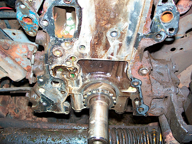

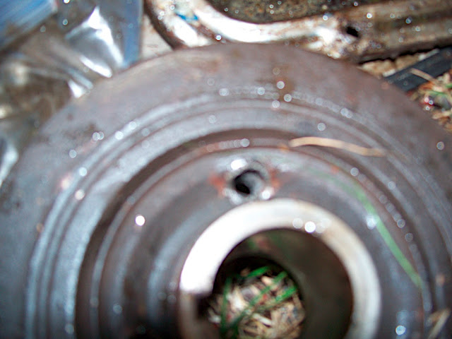

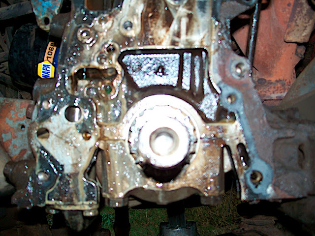

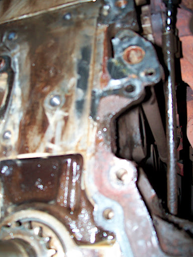

update + timing chain
I took the cover, timing chain, oil pan and all that fun stuff off --
-The timing chain bit grooves into almost everything. A good 1/4 inch into the cover, broke the crank guide/oil pump circle, the plastic guide were in pieces all over the oil pan...it was pretty gnarly.
There are some grooves too on the head were it leads to the aluminum cover...on the inside right of were that hidden 12mm bolt is located beneath the gear -- the vertical bolt.
+++I don't believe that is cause or need to replace the head??
I've got a new timing chain kit, cover and gaskets. I'm putting up pictures now...

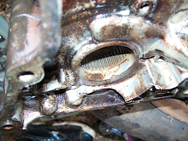

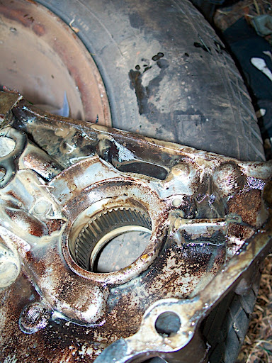

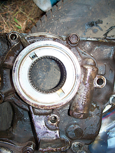

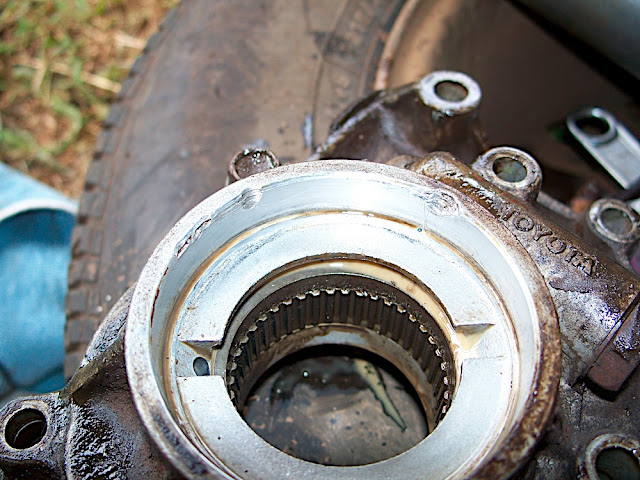

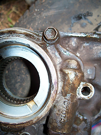

--If you notice the oil pump -- where the rubber seal fits in...there was some damage...do i need to replace the oil pump or will the oil plug and some gasket maker do alright??
---it's not an expensive part but if it's not going to lead to problems, i'd rather not buy a new one...thoughts?
--there are pictures of it--two spots

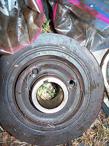

--also, the crank stripped two internal bolt holes...i found two busted (small) internal bolts inside that i pulled out with needle nose pliers. ??Is this going to need replacement or can i just stick the bolts back in and add some gasket sealer...i'm pretty sure that they just act as an opposite torque internal so that the whole thing just doesnt spin around....
Thanks for the help..
what do you think -- no need to pull off the head & do the head gasket? Looks like i can make it out alive with just doing the timing chain gig??
thanks guys!!
http://picasaweb.google.com/zastrowa...imingChainJob#
last thing...anyone know the right way to flush this whole system out before and after reassembly?

Nope, shouldn't be. By the way, when you replace the TC cover, don't forget to add a bead of FIPG or RTV around the bottom edge of the head where it contacts the TC cover.
I'm not sure, but I would replace it if it were my rig. You already have it off, and better safe than sorry.
Looks like it to me, but I would still pull all your spark plugs and make sure that you don't have one that is squeaky clean. It would suck to do all this work, and have BOTH a blown HG and the TC issue at the same time...
Here is a link to a forum discussing that:
https://www.yotatech.com/forums/f116...-flush-196581/
Good luck man!
