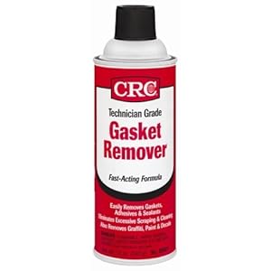

The best solvent I've found for dissolving really tough gunk is CRC 05021 Technician Grade Gasket Remover. But be very careful with it - it will even melt nitrile gloves. Wear eye protection. Don't get it on your skin, or even near any paint. It'll destroy any rubber or plastic too, if left on for more than a few seconds. But if you can remove the metal tubes to give them a good soaking, it's worth a try. Just keep soaking it and giving it time.
Forget Permatex's Gasket Remover - I still have a can of the old formula and it's great; but they changed the product to make it "safe" and now it wouldn't remove wet paint.
