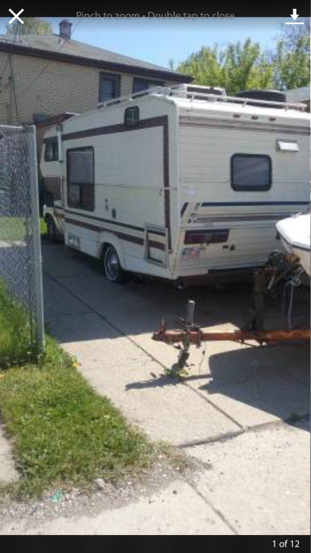

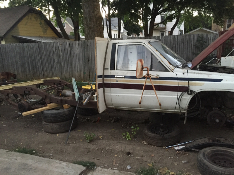

So where to begin? Just bought a Toyota 1984 mini motorhome 22r 2.4L welded extended frame , turns out that it's got the death dually's , it only has 60,000 miles on it and it looks like the rear end is just been serviced new brakes , sealant on the differential cover ... Huge leaf springs since the air ride blew out .

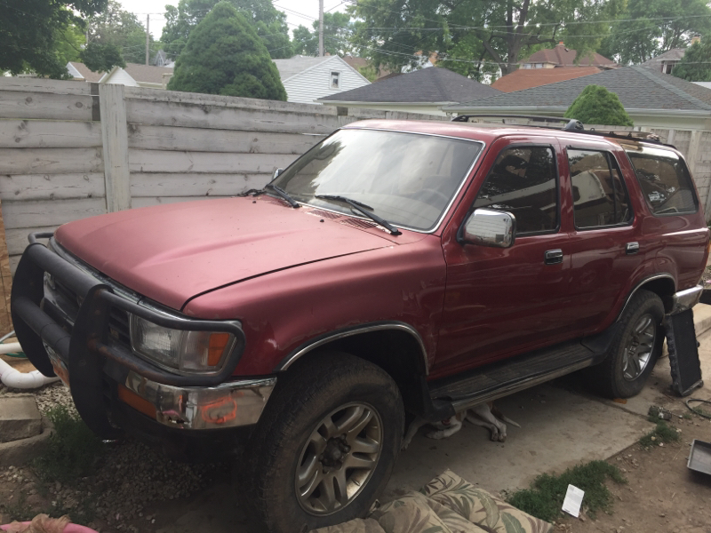

So I have a 1995 4Runner in parting out and the frames almost the same , I'm thinking grind the old welds remove the 84 reared and weld it in so I get the 6 lugs anti sway gear and slap some air ride in the coils , and finally get rid of the dually rims , what to do...

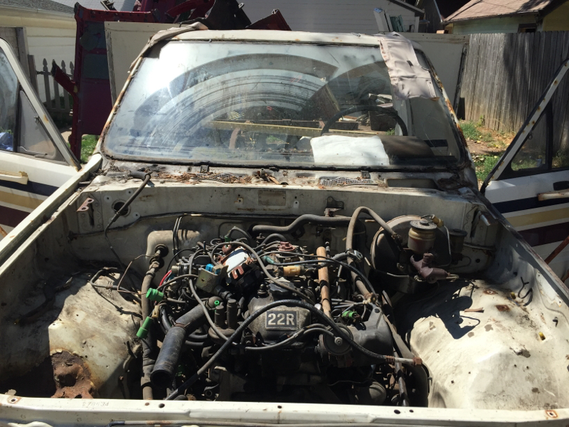

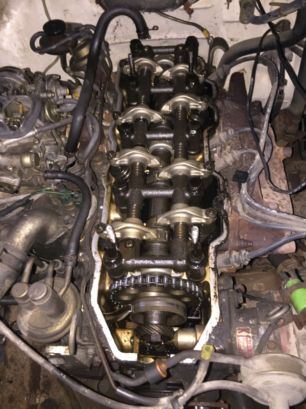

Here she sits now , how much play is normal in the timing chain ? Guides are ok and it looks like the head was redone .

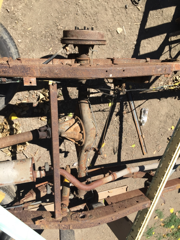

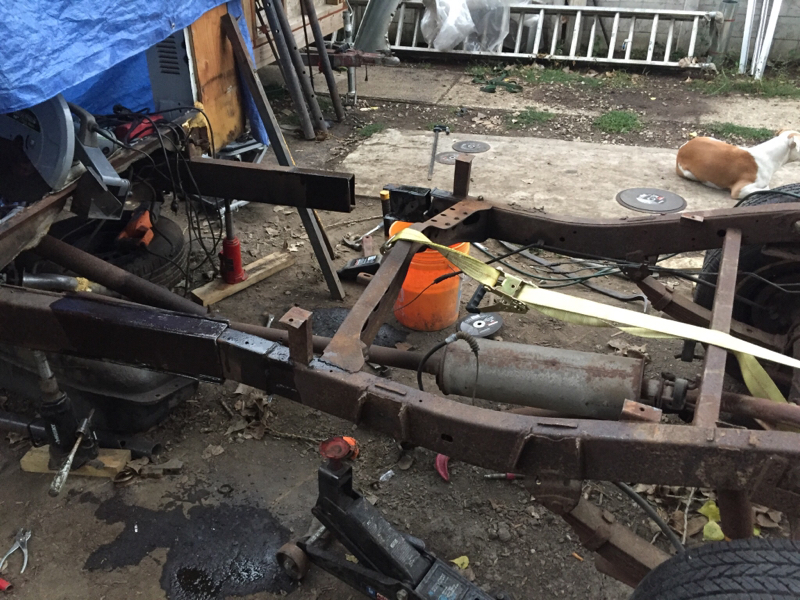

Death dually fix ? Tiny house build 1984 toyota to 1995 4 runner rear end swap help-image-2028809081.jpg
Pretty rickety
Attached Thumbnails Death dually fix ? Tiny house build 1984 toyota to 1995 4 runner rear end swap help-image-4016423721.jpg

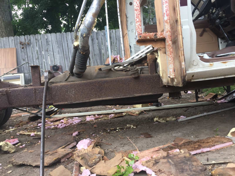

Death dually fix ? Tiny house build 1984 toyota to 1995 4 runner rear end swap help-image-777599642.jpg
Cut the welds and she's loose
