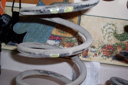

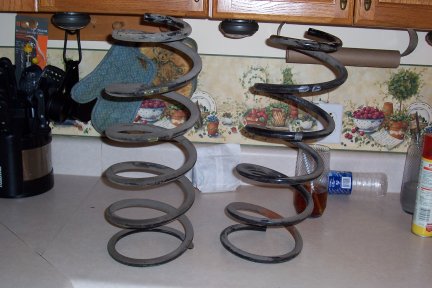

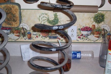

904x4Runner here are the pics of the springs i have
Attached Thumbnails correct rear shocks for a 2.5" rear lift (4Runner)-lc-rear3.jpg   correct rear shocks for a 2.5" rear lift (4Runner)-lc-rear2.jpg   correct rear shocks for a 2.5" rear lift (4Runner)-lc-rear.jpg
