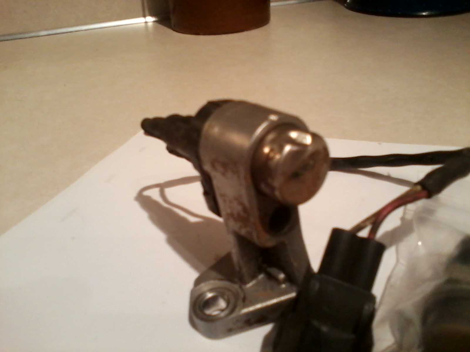

WYOMING!!! Uploading photos now, we're pretty sure we found the culprit......
Old Feb 1, 2015 | 02:12 PM
oregon taco's Avatar
Joined: Nov 2008
Posts: 71
From: oregon
Our new mechanic found this and said it looked like someone took a chisel too it. He's replacing it as we speak and we're bringing her home tonight, after 2 months of PURE HELL. Those wonderful engine mechanics will be hearing from us.......
Attached Thumbnails Coil Pack Spec Range-0201151426.jpg   Coil Pack Spec Range-0201151428.jpg
Old Feb 1, 2015 | 02:21 PM
wyoming9's Avatar
Posts: 13,381
Likes: 100
Red face
I hope this does it .
I will keep my fingers crossed .
We will see.
