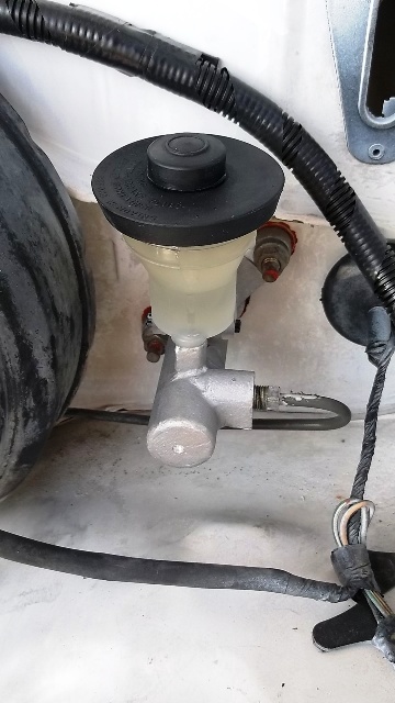

After all this work I've done on my 91 4X4 I'm having trouble with simply bleeding a new clutch master Cylinder. It obviously worked when I pulled the rig into the yard. I've looked around elsewhere, I've seen some pretty weird stuff(the cutting a bolt lengthwise with a hacksaw and inserting a wedge to increase bolt size really threw me) Anyway I did a slave about 25 years ago no big deal, I follow the haynes manual, nothing allows me to "pump about 10=20 times until pressure is felt and then yada yada yada..I adjusted the throw to match the old one. No matter what I do it won't pump up, I can't find any leaks..Do you have to "prime" a new master cylinder? I checked the flare it looks fine. The pic shows some kind of film or skin on the outside of the line(looks like some kind of original protective skin(packaging) the white stuff in the pic next to the fitting
Any suggestions, this is just pissing me off as each time I open the fitting I spill a reservoir's worth of fluid..

I have had bad parts out of the box from part stores. Is your slave cylinder trying to build up pressure? It could be the culprit now.
Try bench bleeding the Master Cylinder with it off of the truck. If you can hold the pressure back with the force of your finger, it is bad. If working right, with just about all the strength you can muster it should blow fluid past your finger.
Also I swap out the master and slave cylinders out as a pair anymore. Seems like when I changed one of the two in the past, the other one will fail at a later time. My guess is the increased pressure just eventually takes it toll on the other one.

From the amount of time and searching I've done on this site I can tell you that there are many out of the box failures from all of the parts stores, especially AutoZone. There are also many stories of early failures from the same stores. The only parts store replacement I've read of that seems to be decent is from NAPA.
Personally I wouldn't do that either when you could get the original Aisin parts for about the same price if you do a little online hunting.
Unlike the normal parts store replacements the Aisin stuff seems to work right out of the box and last a very long time.

It seems since the rubber line is not attached to the slave cylinder it almost never gets changed.!!!!
Just like any hydraulic lines they do tend to balloon under pressure.
I have had good luck with the Aisin hydraulics after dealing with junk till I learned.
I keep extras on the shelf.

Solution is to replace the whole system with new
On all advice Thanks, too bad I bought the clutch job from AZ, so far NAPA on everything else, AZ claims lifetime warranty, even took my info for it. NAPA $34 for master and $18 for slave. AZ was $23 for master and $12 for slave. So I saved a few bucks, might not have been worth it. I cranked on the master line so hard I thought I'd strip it out. So per the advice here new master and slave, original Toyota line from junkyard looks untouched since install $8(a hassle pulling it out without damage), I already replaced the rubber flex due to a goober(not long enough to accommodate the 3 inch BL, used a front brake line new that belongs stock in this vehicle, a perfect fit with perfect slack.. I don't believe in spooks and magic so a complete replacement should solve it.
Sad to say it's probably going to turn out the original MC was perfectly fine, just a bad set of troubleshooting skills applied in this case, and a rush to get it up and running
