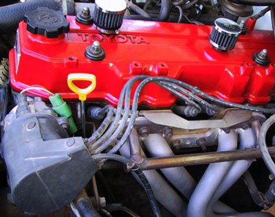

i found this other one...
i dont know if this person put 2 of them on for the reason of the vaccum leak.

your engine doesn't suck air through the valve cover how would it get more air if adding a breather filter? Well it will get more air by sucking in air through the breather via the PCV valve but all that takes place effectiely bypassing the AFM. Which means the motor is getting more air to it than the ECU sees, which can possibly cause a lean fuel mixture, which is a no no on any motor and is absolutely a very bad thing on a turbo motor.
The photo above is fine since your disabling the PCV system. But the PCV system almost adds to you gas mileage not takes away from it. This is only in theory though since the PCV system is meant to allow you to burn un burnt gas fuses from the crank case.
People do these things because they do not understand how an engine works and thus do not understand what the consequences are of such modifications. They do them because of the "cool" factor. But IMO there is nothing cool about possibly running your engine lean and therefore warping heads, burning valves, putting a hole in a piston etc etc.
